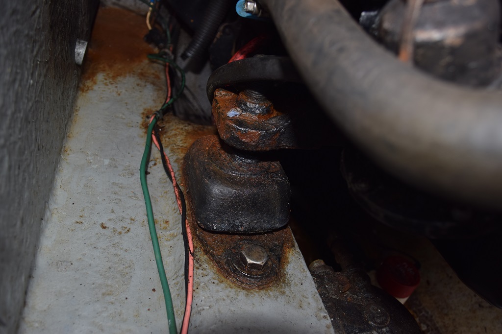

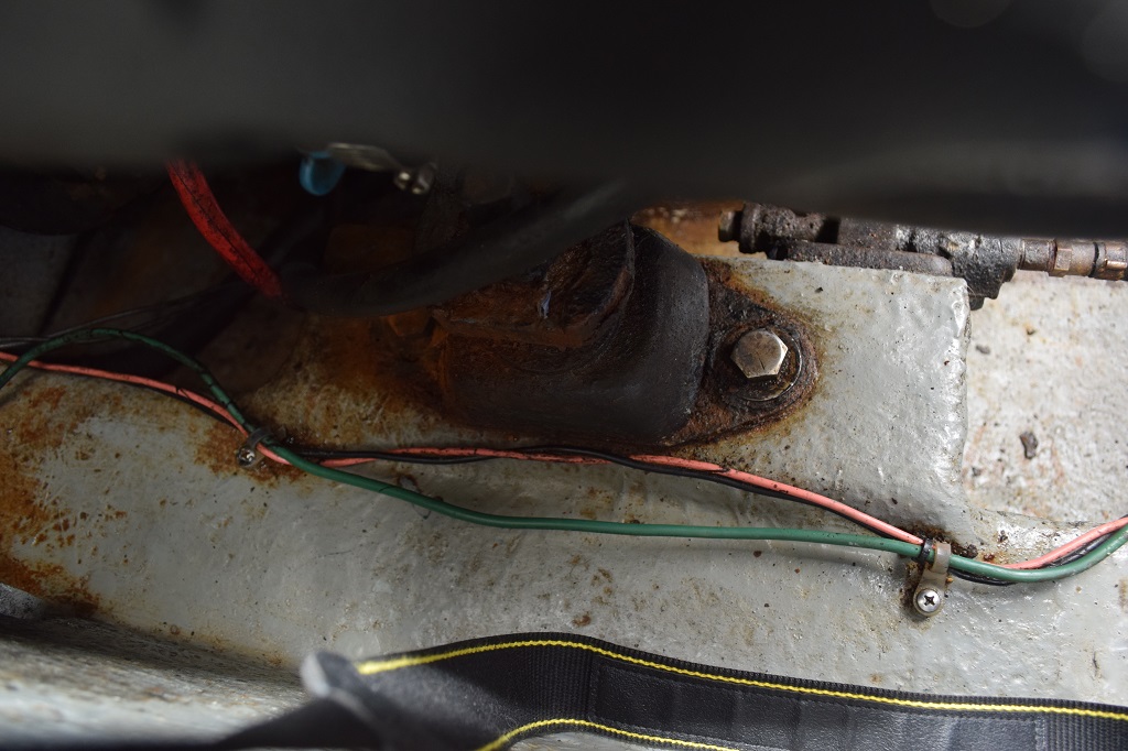

Here are some photos of the old mounts in place......

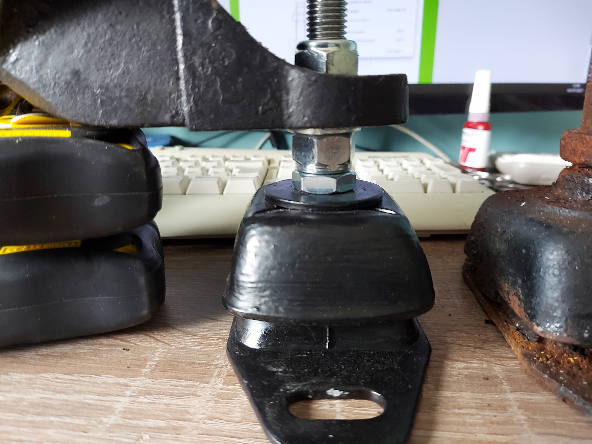

Trying to get some new mounts was a challenge as most places were "Out Of Stock". I did find some at Repower Marine but I was advised their flex was a little weak for the engine and the weight capacity was a little low, but as I said earlier, I found some.

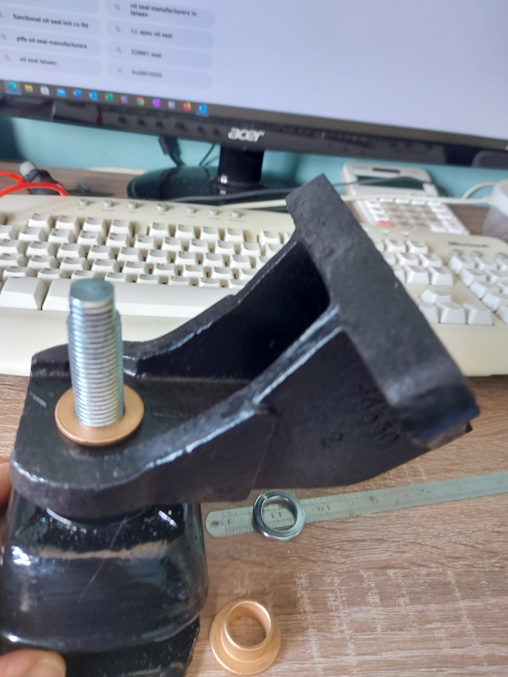

The mounts from AV came with 16mm ordinary zinc coated height adjusters, washers and nuts, so I bought some 16mm Stainless Rod, Nuts and washers from Sea Screw and fitted these. Cut the rod to size with a hacksaw and took some of the thread off with a Dremel Cutter to get a spanner on to tighten. The old mounts had ¾” adjusters (I said earlier they were ½” but that was the bolts holding the mounts to the boat mounts) with fine threads and the 16mm were rattling in the hole of the mount brackets, so I thought rather than have the work loose I found some Bronze Flanged Sleeve of the exact sizes. The height adjusters from AV mounts came with self locking nuts but were way too big as the Mercruiser mounts were fitted with half nuts. I was concerned that half nuts on an ordinary thread would not be strong enough but consulted with Gareth Jennison (Gazjen) who set my mind at ease, thanks Gaz.
New mount painted with Epoxy paint then covered with High Temp Plastikote....
Bronze inserts in place

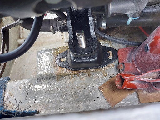

I dry fitted them, the Starboard mount lined up exactly with the holes in the boat mount support, but the Port mount holes were way out. Yet another setback and what to do, possible rebuild and boat mount modification? I posted on iBoats to ask about their thoughts and was advised it was probably installed originally with a 4x2 because they cut the holes in the wrong place, you naturally don’t like to think they would do this at the factory but it was a logical shout. After figuring it out I bought a plug cutter and filled the front hole with an oak plug and epoxy, the rear hole wasn’t far out so it only needed a little adjustment. Whilst doing this I figured I ought to check alignment each time and as I had only lifted the engine sufficiently to remove the mounts when I lowered it back on the new mounts, it wasn’t far out.
New mounts dry fitted
Not aligning with holes B.jpg (99.88 KiB) Viewed 44428 times

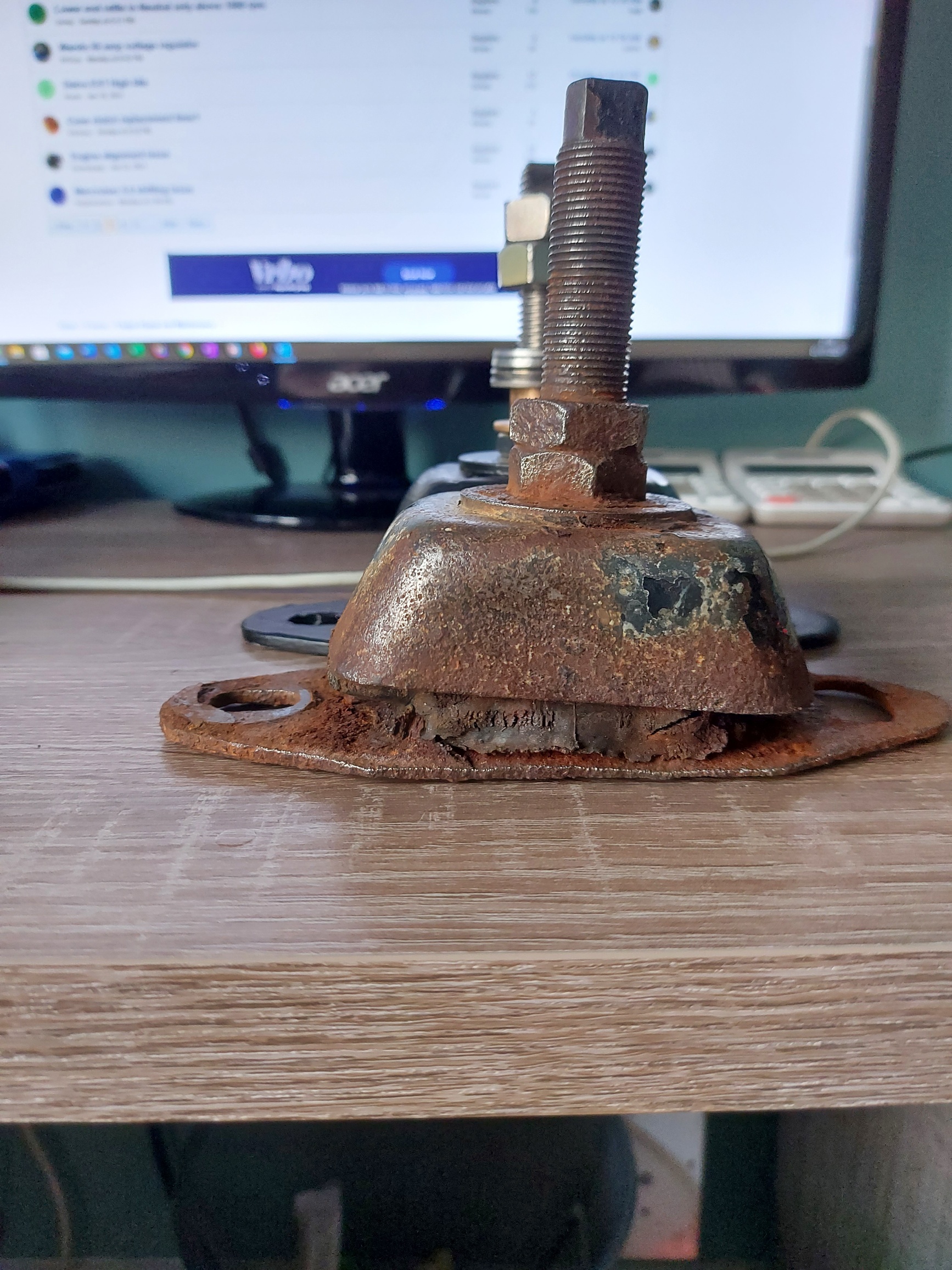

Here's why the new mount wouldn't fit, the old one had a set in it just enough to fit the holes, definitely had been forced into place.....
