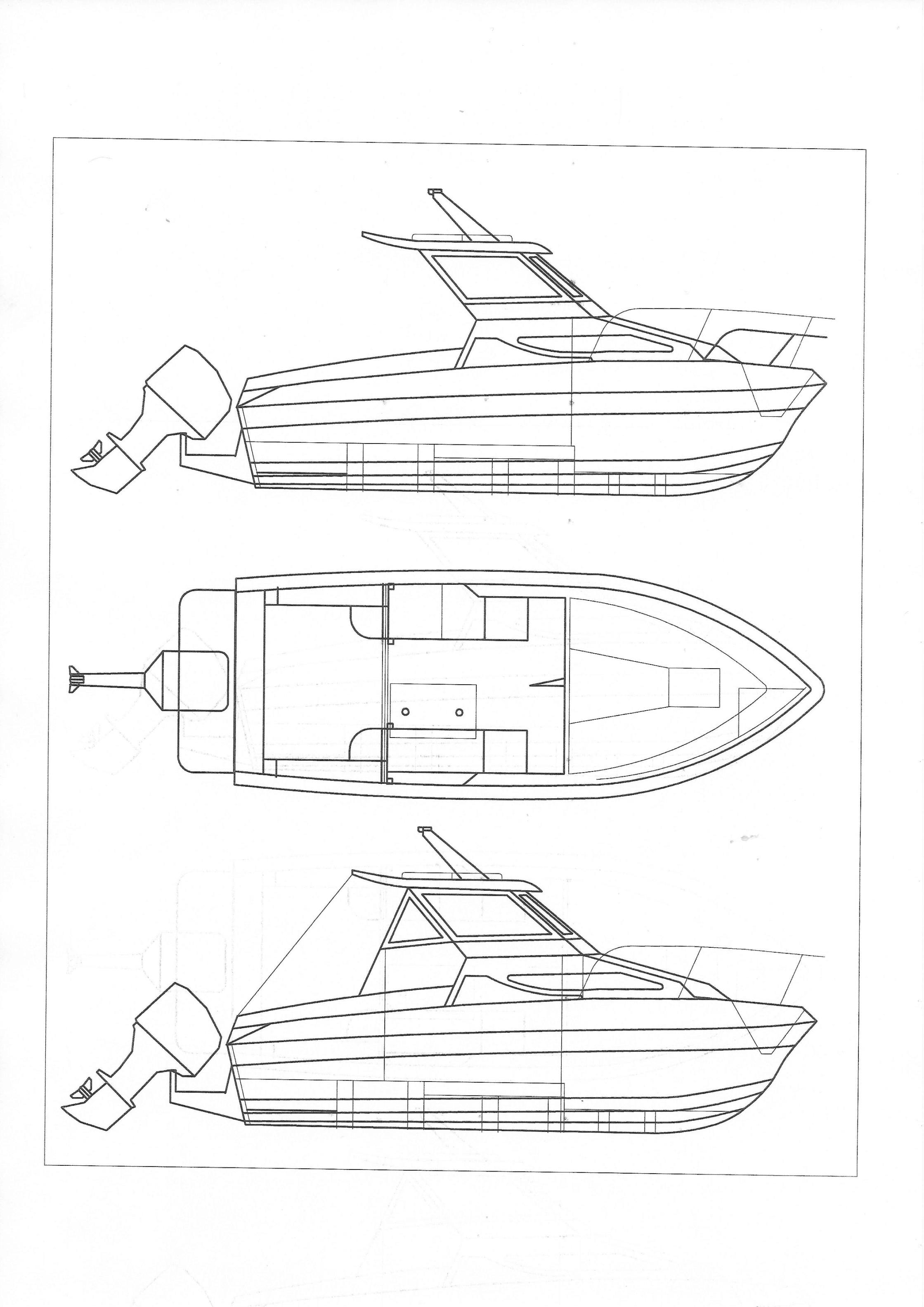

Not any more photos yet, but I will post up the latest iteration of what I hope to achieve. The top drawing is of the open fisher, with just two v berths and a porta potti. The centre drawing shows the layout of a small enclosed wheelhouse with a small kitchen/eating area and the bottom drawing shows the side view of the enclosed version. I have not yet decided if the "enclosing" will be soft (just canvas/pvc, semi rigid by sandwiching a thin panel in the canvas or to make it a more permanent arrangement, remembering that this is just a small boat. Geoff
1 A DRAWING 3.jpg (422.46 KiB) Viewed 24985 times
by Ianfs » 28 Sep 2018, 08:22
The reason I asked about the hours Geoff is that when you may have finally finished everything else, you'll have a record of the build.
It'll come in handy if you ever wanted to make another or even sell on the moulds. :)
