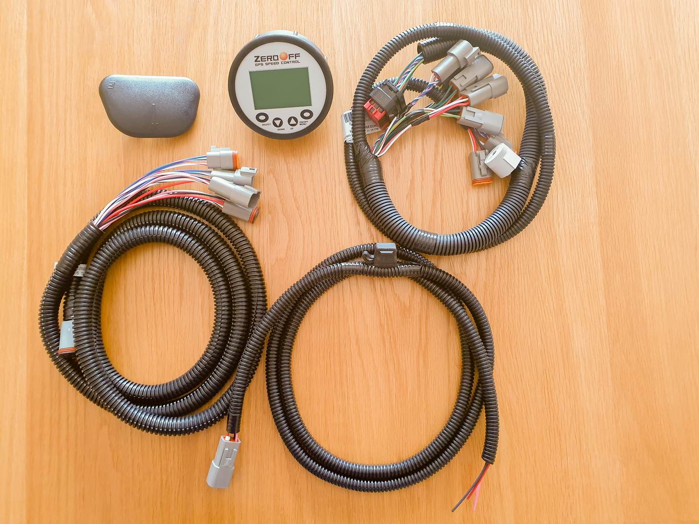

First off this is the bunch of items I need to connect up ….. it looks a whole lot of wiring.
L resize131.jpg (244.35 KiB) Viewed 13104 times

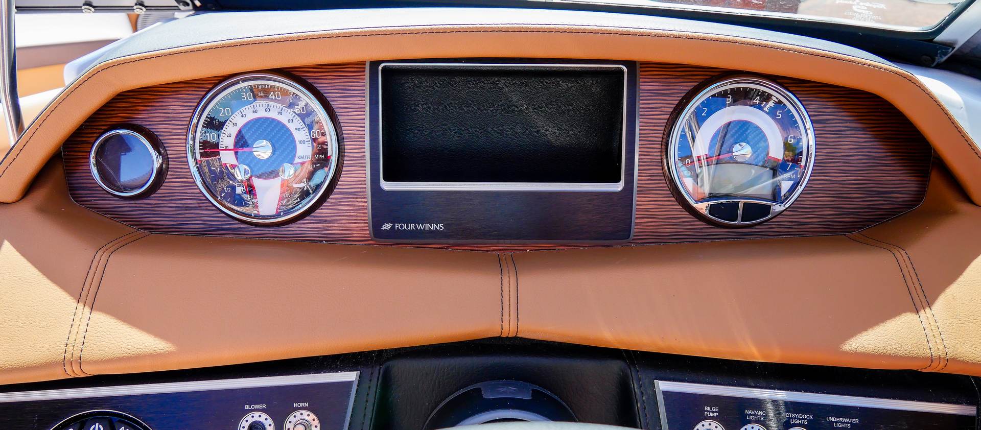

Initially, I bought the 5” display, but there was not an easy way to mount the 5” display in my dash …. Changed kit for a 3.5” display instead.
The dash looks like ……
L resize41.jpg (253.95 KiB) Viewed 13104 times

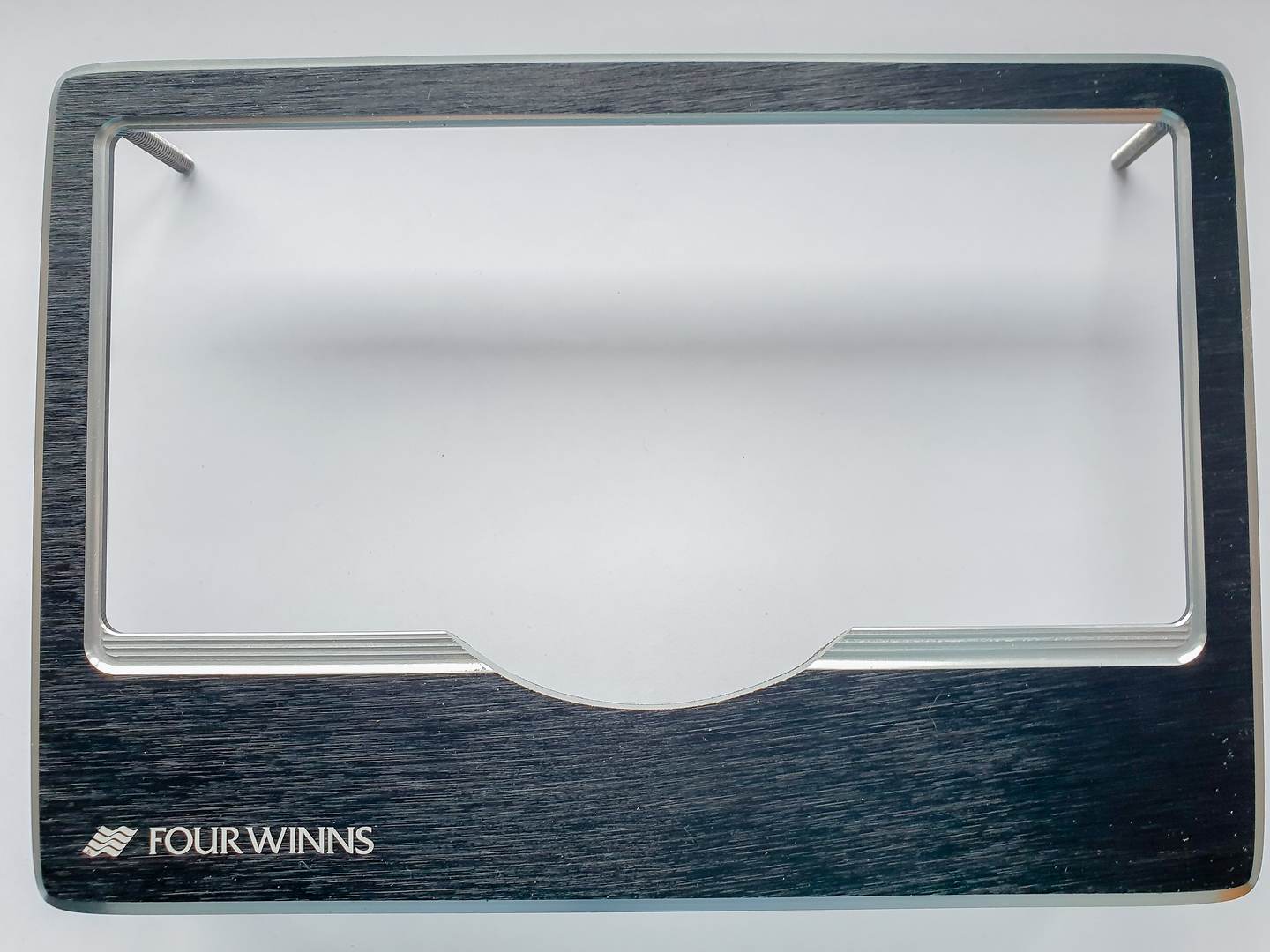

In the centre is where they fit GPS if you order it …. What it comes with without GPS is the Aluminium frame and a recessed angled ‘accessories’ shelf, for sunglasses or phone.
After lots of consideration and suggestions from many, decided to remove the rear ‘accessories part’ that released the frame - I very carefully filed a curve to exactly match the display dial.
L resize81.jpg (158.79 KiB) Viewed 13104 times

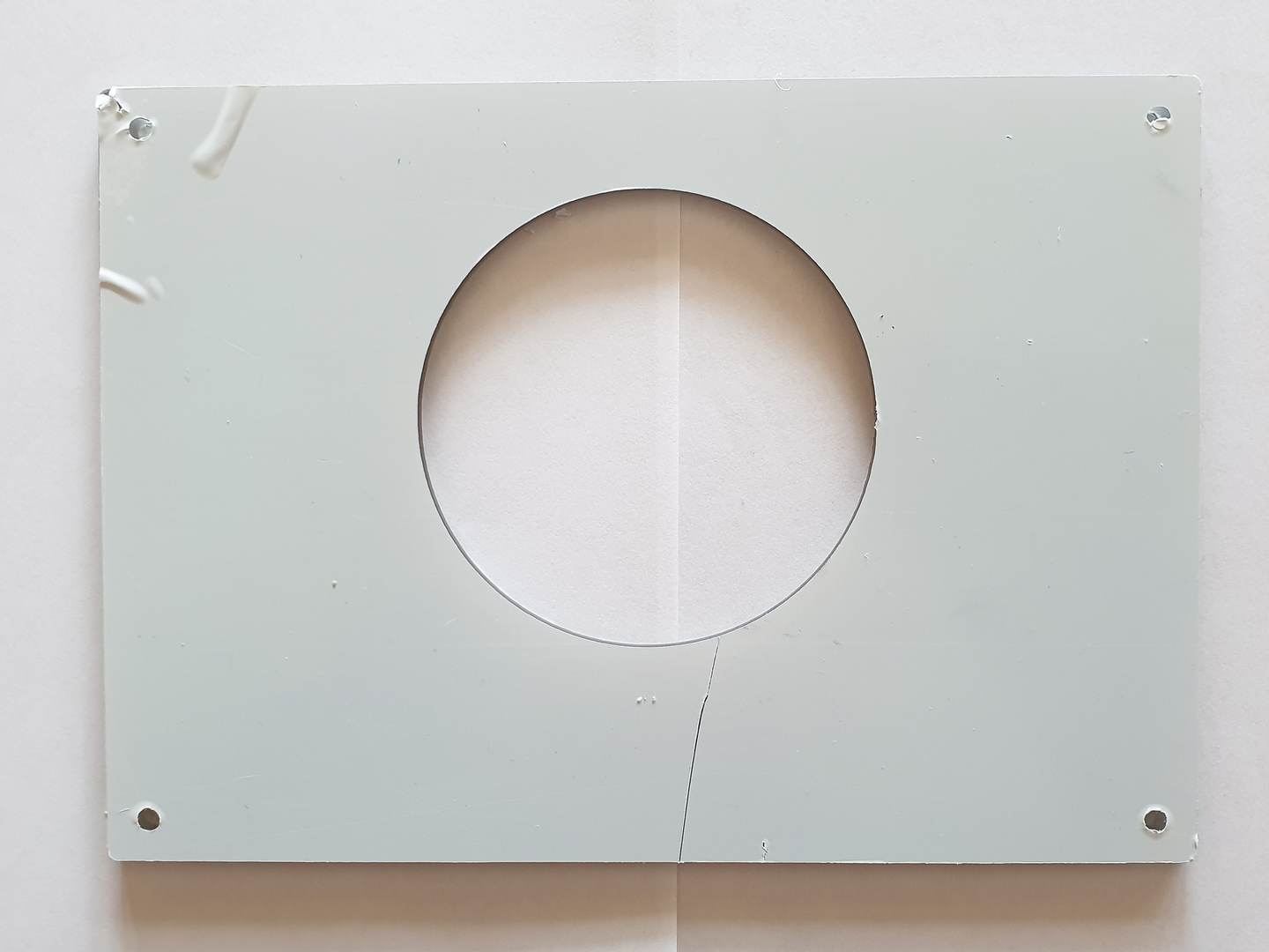

Decided to fit a flat ‘blanking plate’ and mount gauge in that, with some effort to make it neat.
I then with some accurate measurement had produced a drawing of what I wanted .. and had a neighbour turn that into a CAD file for me.
Took this to a Graphics shop, and had it CNC routed out of 5mmm acrylic.
L resize121.jpg (64.66 KiB) Viewed 13104 times

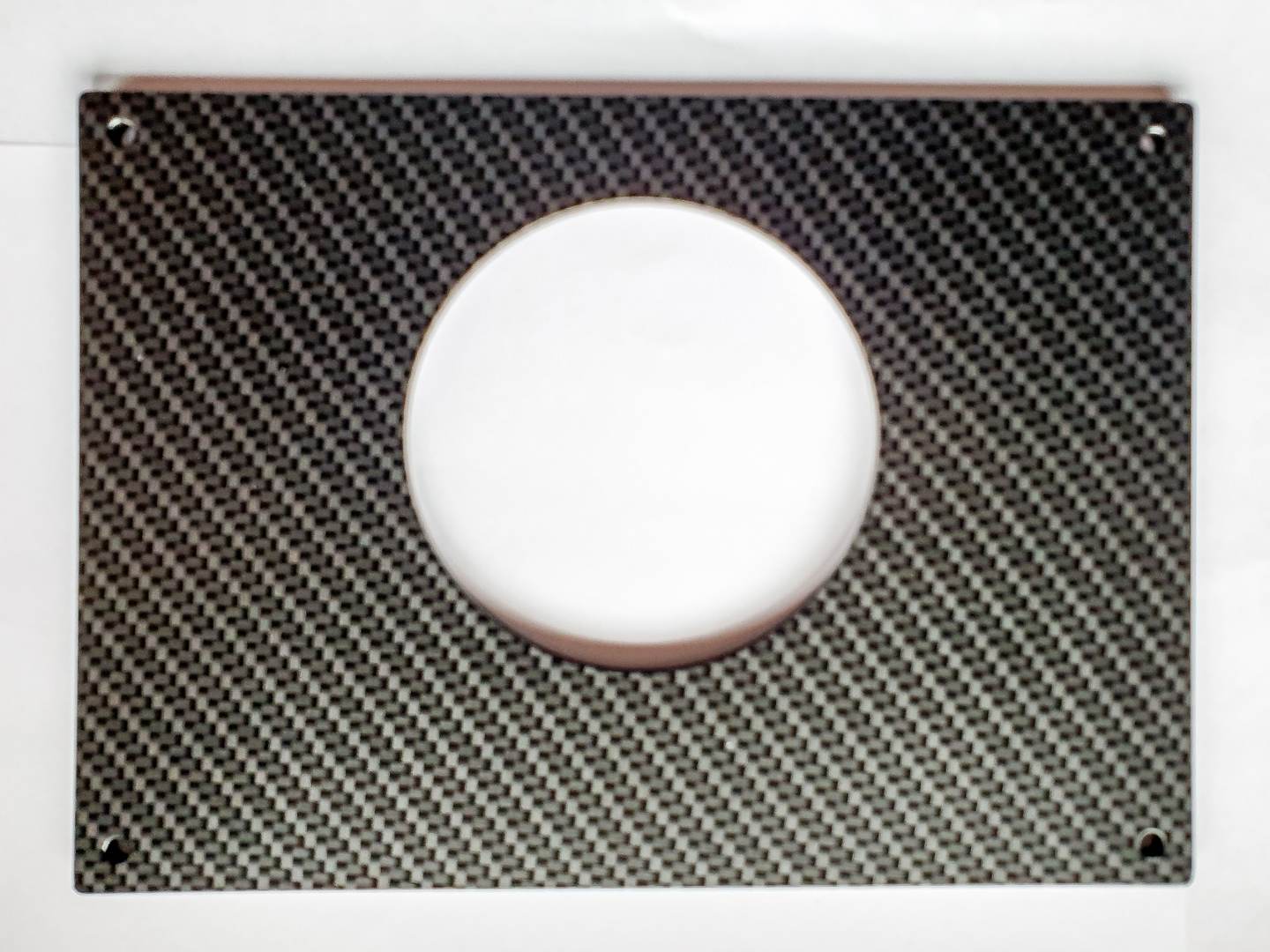

Now I could have painted the acrylic, or left as glossy plastic ….. but wanted better as a new boat, so instead took it to a Hydrographics shop and had it Wet Transfer Printed with a Carbon fibre finish
L resize71.jpg (197.68 KiB) Viewed 13104 times

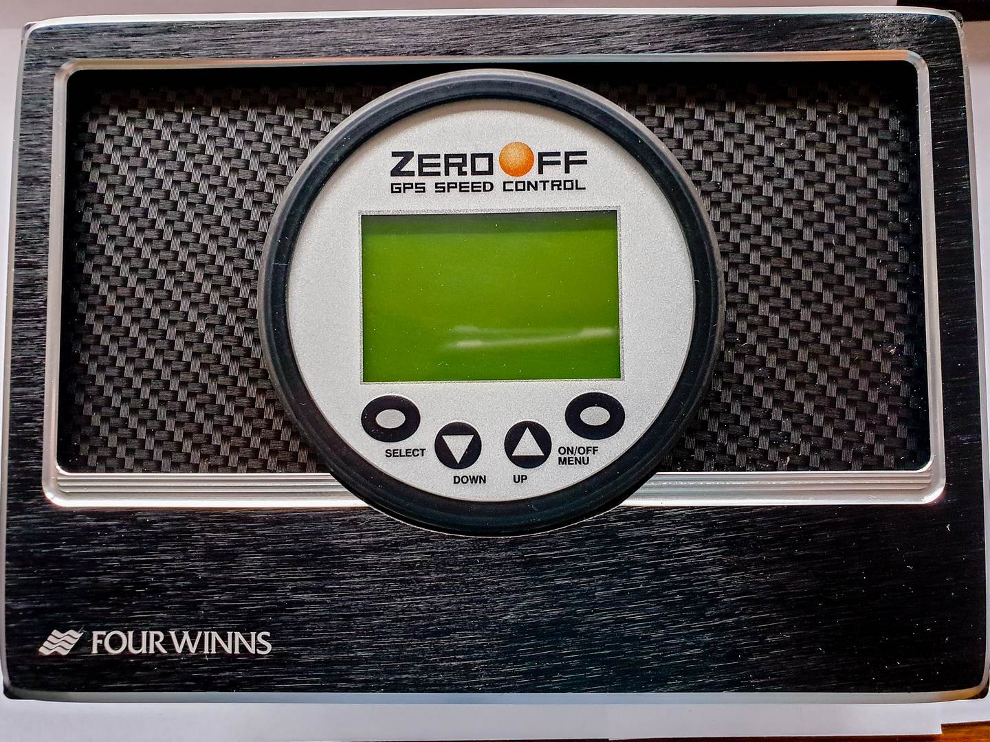

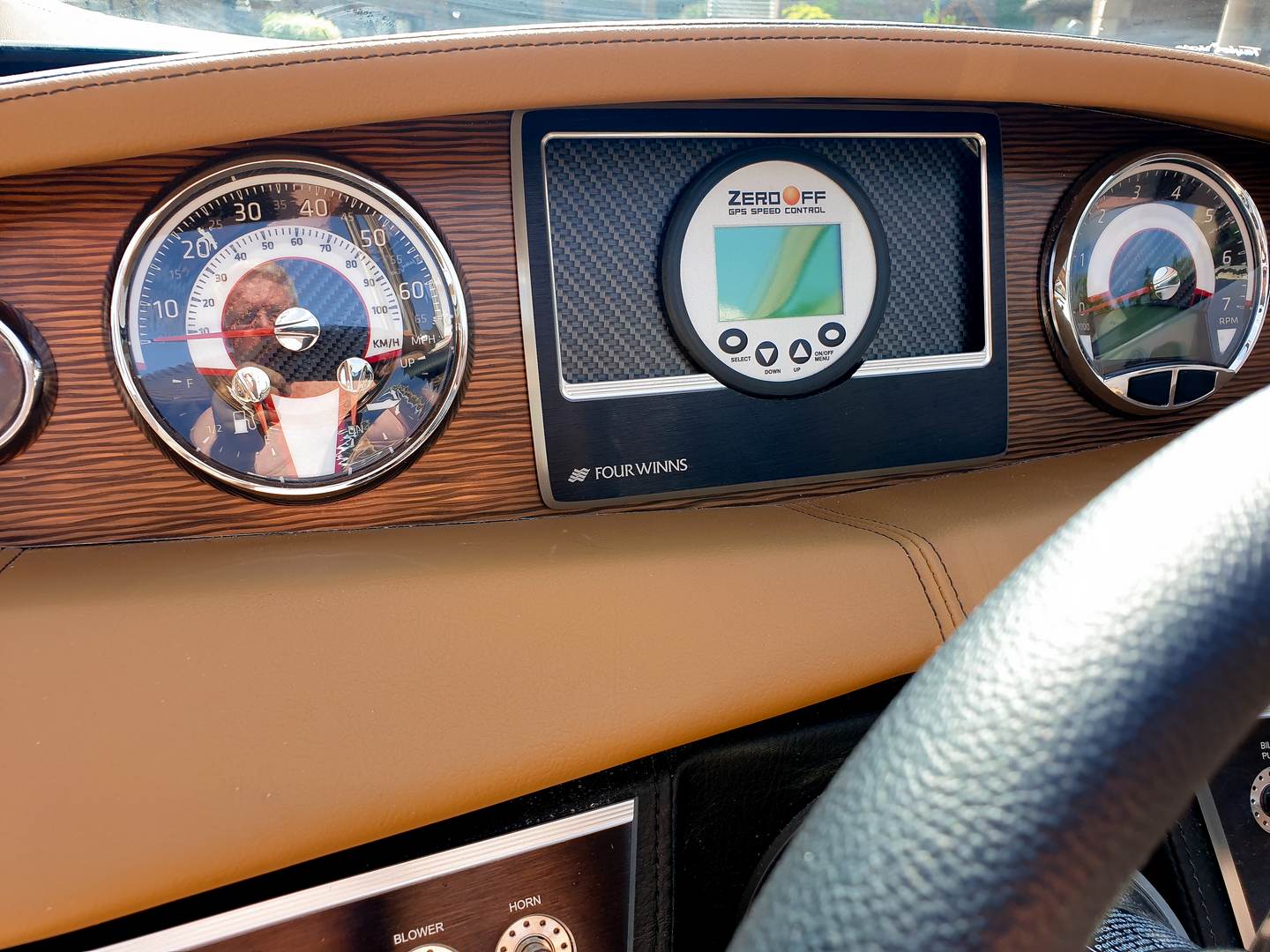

Now assembling all 3 parts I can see the effect I wanted.
L resize91.jpg (331.06 KiB) Viewed 13104 times

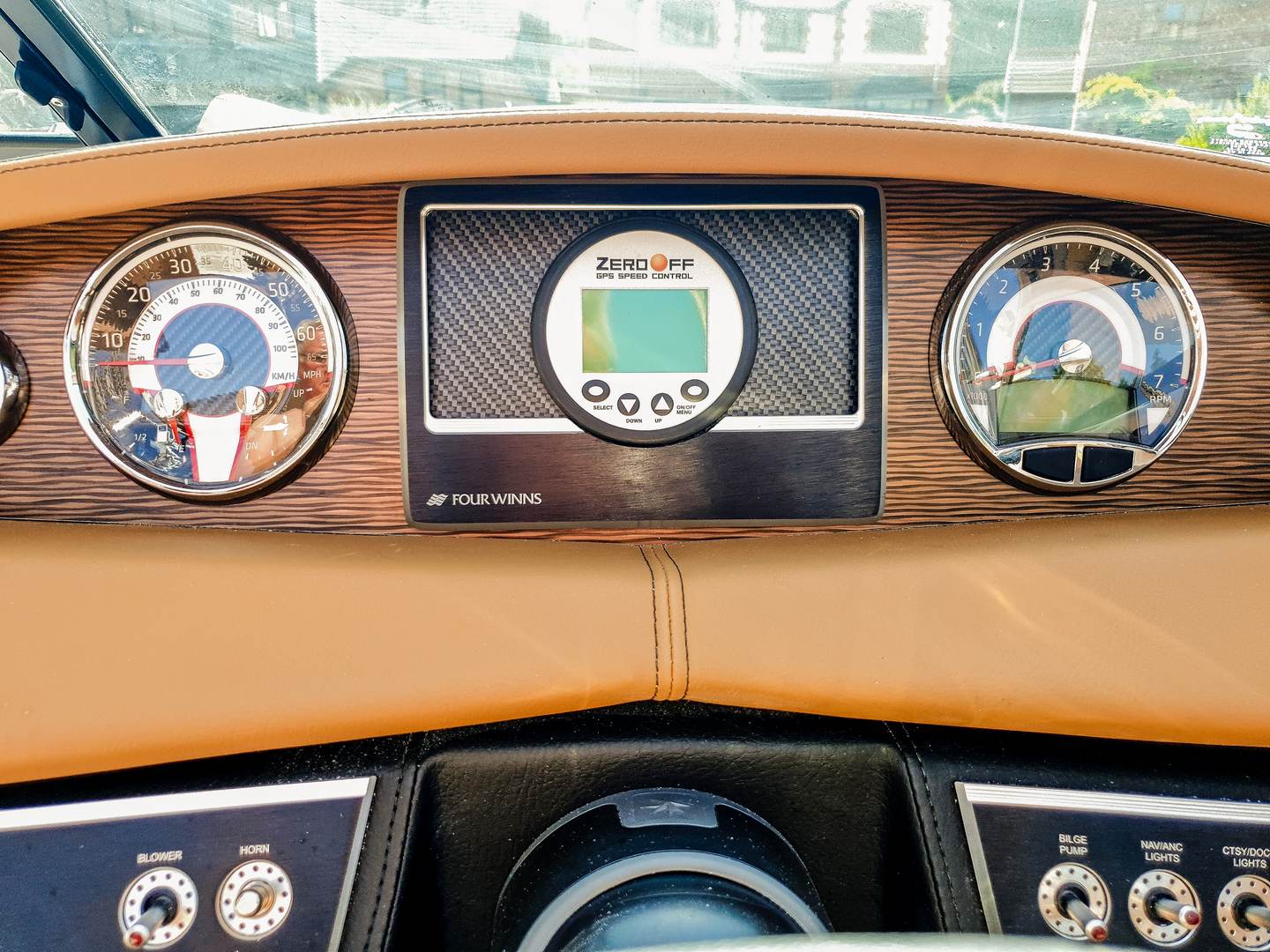

Then pulling it all together the finished item was installed in the dash.
L resize61.jpg (272.75 KiB) Viewed 13104 times
L resize51.jpg (231.52 KiB) Viewed 13104 times

by argonaut » 11 Sep 2020, 19:28
Just an update .... GPS was working ..but speed control was not working.
Support from ZeroOff was superb, gave me a couple of tests, and got me to provide data from diagnostics, and advised the issue was reversed CanBus signals ... boat wiring schematic had colours reversed.
Pull 2 pins in a Deutsche connector and swap them over .... and it worked.
Absolutely excellent in practise .... you accelerate at whatever rate you want, when you reach set speed ... It beeps and takes over.
Keeps to within 0.1mph, even in turns.
Great for rider being towed ... pull is so consistent.
There are options to customise the pull in terms of aggressiveness to load, and to loss of load (slack rope)
It makes changes to speed in 10 rpm increments, so smoothness & accuracy is superb.
