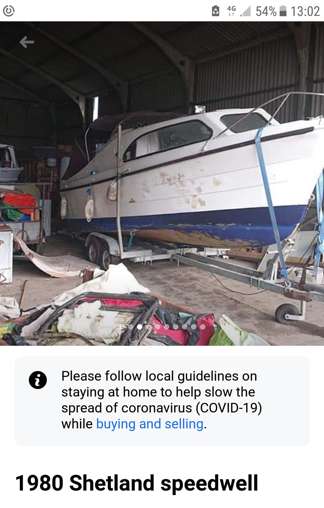

I have always liked the idea of owning a boat & i love fishing so i bought a Shetland Speedwell. It was delivered on Wednesday and i have begun stripping it out. With no idea about boats other than the research i have done i will be very grateful for advice along the way. Thanks Wes

A little more info. The trailer is not a boat trailer but has been modified slightly, not very well either and this will cause problems later! The outboard is a suzuki dt20, not been tested yet.

The boat looks like its good form and should be great for fishing. The trailer looks like a bike or small car trailer, but maybe with a couple of bunks added could work ok. There must be a plate, normally at the front somewhere which specifies the overall trailer carrying capacity or gross weight. Then its only a matter of knowing
how heavy the trailer is plus the boat will fuel, water and any other bits you want to add.
I'm sure that outboard is ok too, they are pretty bomb proof.
Looks like a pretty good starter boat.

I think the trailer capacity it 1034kgs. I will more than likely have to jack the boat off the trailor to access the hull for sanding & painting, when the boat is complete i will moor it then i have the option of trailer work.

The boat probably has a dry weight of around 600kgs and the engine is about 50kgs so with a capacity of 1000kgs the trailer sounds strong enough.
I took my boat off its trailer a few times and it weighs in at around 900kgs. It's a fairly easy job but it needs to be taken with great care and done very slowly.
If you drop the front jockey wheel as far as it will go the stern will lift by about an inch or two. put a block under the stern at the keel, support the chines (sides) and then jack up the jockey wheel as far as you can, within reason. This will lift a lot of the rear boat weight off the trailer, leaving the bows on the trailer. It was easy with mine because its a roller trailer but you seem to have supports and I cant see any rollers, unless that's a keel roller I can see. However with the double bars on the front of your trailer maybe you could put jacks on the keel and roll the trailer out. Obviously when you get to the crossbars the jacks will have to be moved. But I'm sure you'll work it out. I suppose it depends how much space you have.
A thought occurred to me that these tend to be river boats, where will you be using her?
