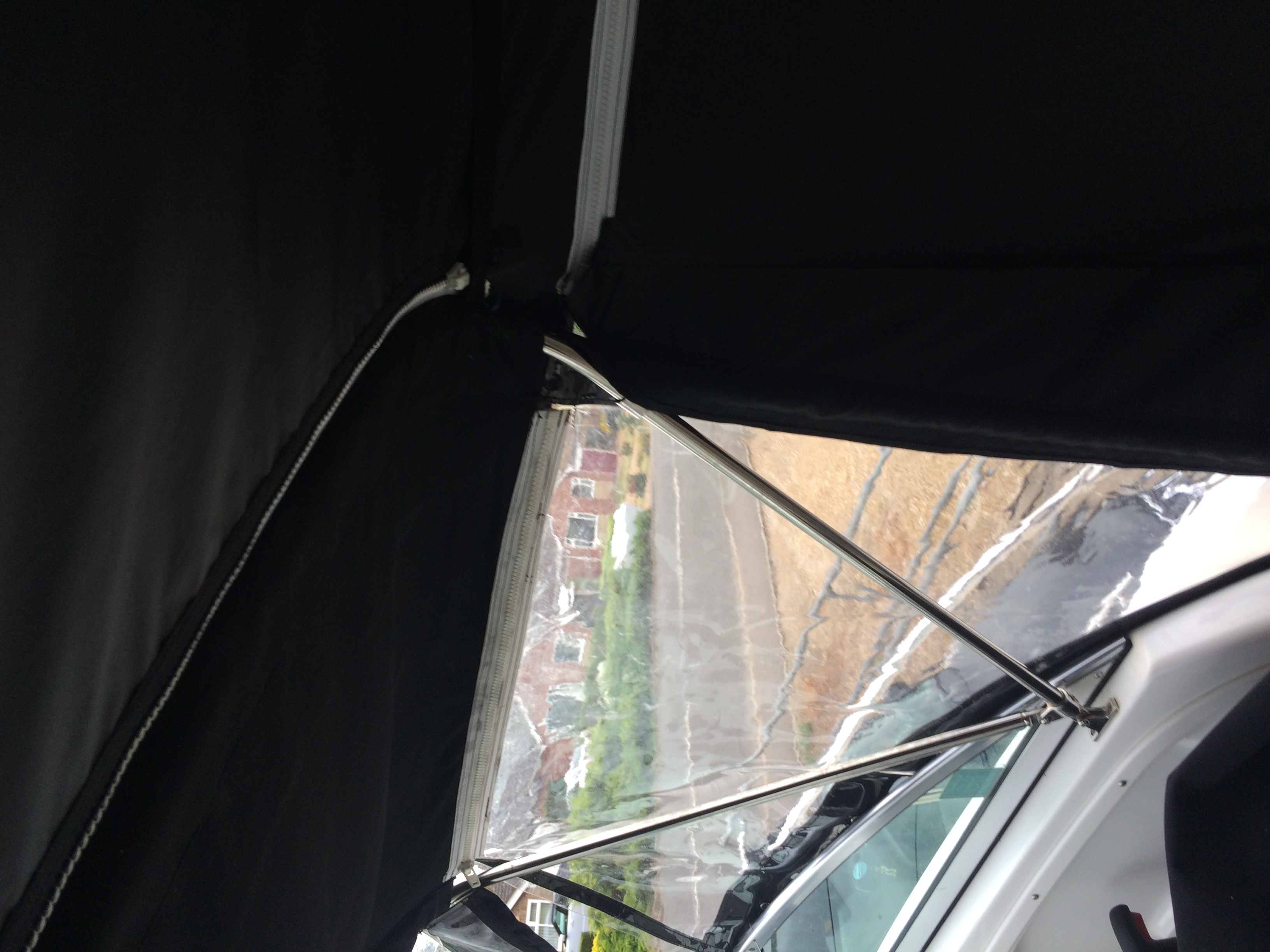

After reading in PBO mag that bending stainless was easy at home 1 sourced 12M of 19mm 2mm wall polished Stainless 316 locally for £85, and £90 worth of 316 Bimini & deck fittings. The belief that 19mm would be easier to bend - HA big mistake (lesson 2) - You cant bend SS at home, YouTube? -forget it. 1st attempt broke the pipe bender and the work mate. I could have persevered with routers and wall mounted benders but it was soon evident that a bimini frame 2300mm or so wide wasnt going to be best for trailering anyway, would spoil the open lines of the deck and be a pain for someone 6'4" walking around the deck on the rivers we frequent with LOW bridges. Plan 2 was formed in the way of a take apart frame that can be stored in the deck long water tight compartment accessed from the cuddy. Using the deck fitting and Bimini hinges it would collapse into 2 legs and 2 roof struts. The problem was/is the corners with a sweeping curve. So far the option is 16mm Ali from Wickes, bent to a curve and slotted in the 19mm - 2mm walled SS. Shop Ali isnt the answer though as it is weak and 1 corner fractured. (this is still on going, the plan is to have a local SS fabricator Mandril bend 22mm SS and braze new corners on the existing 19mm. Other options are to replace al the 19mm SS with prebent 4mm walled Ali -and have it anodised. Lesson 3 wold have been get it done like that to start with but we live an learn for next time. A local Ali Mill will sell 10m of 22mm 4mm walled ali for £30. no brainer really.)
So we now have a frame in place and stored when required albeit carefully for this season.

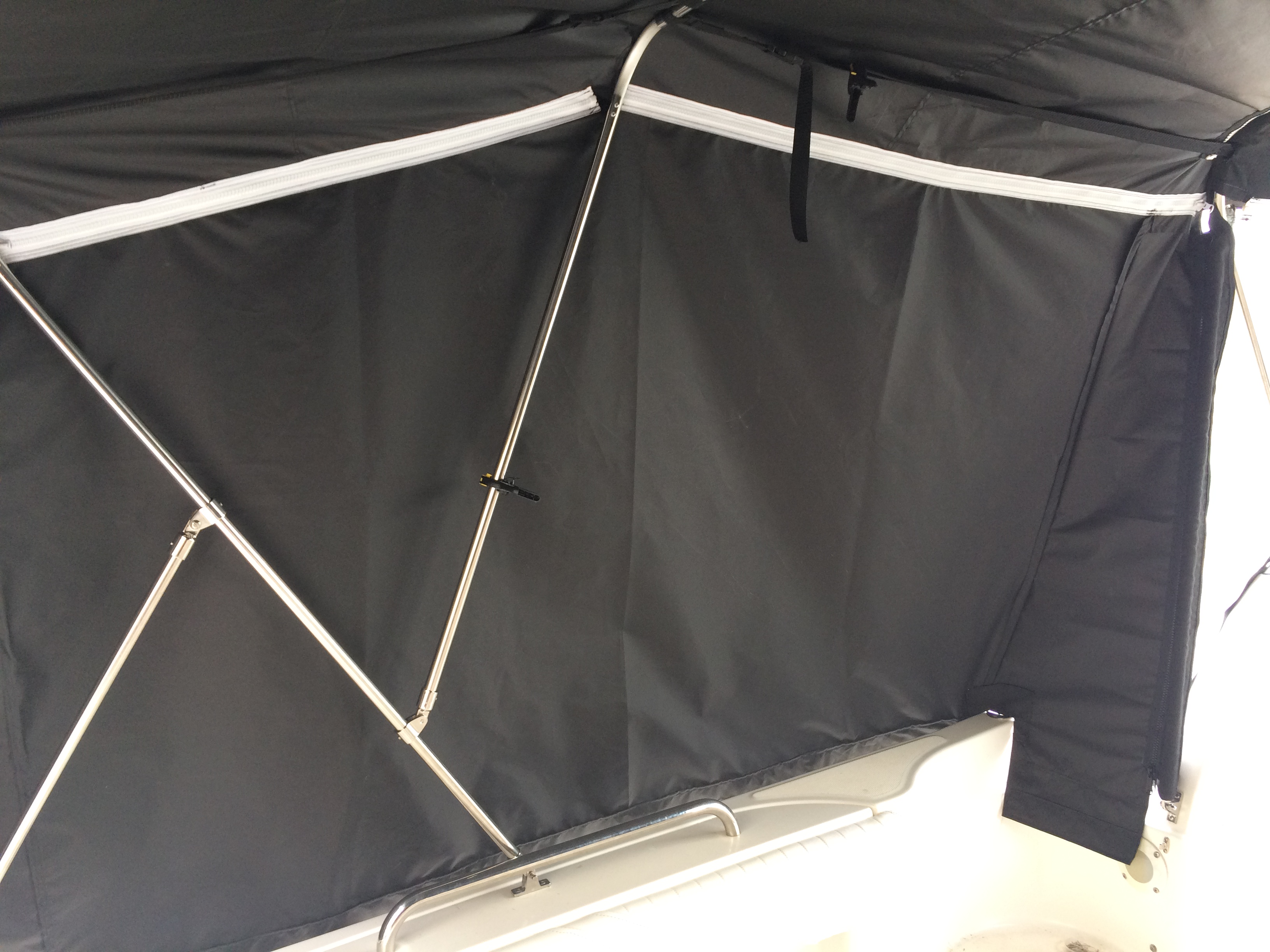

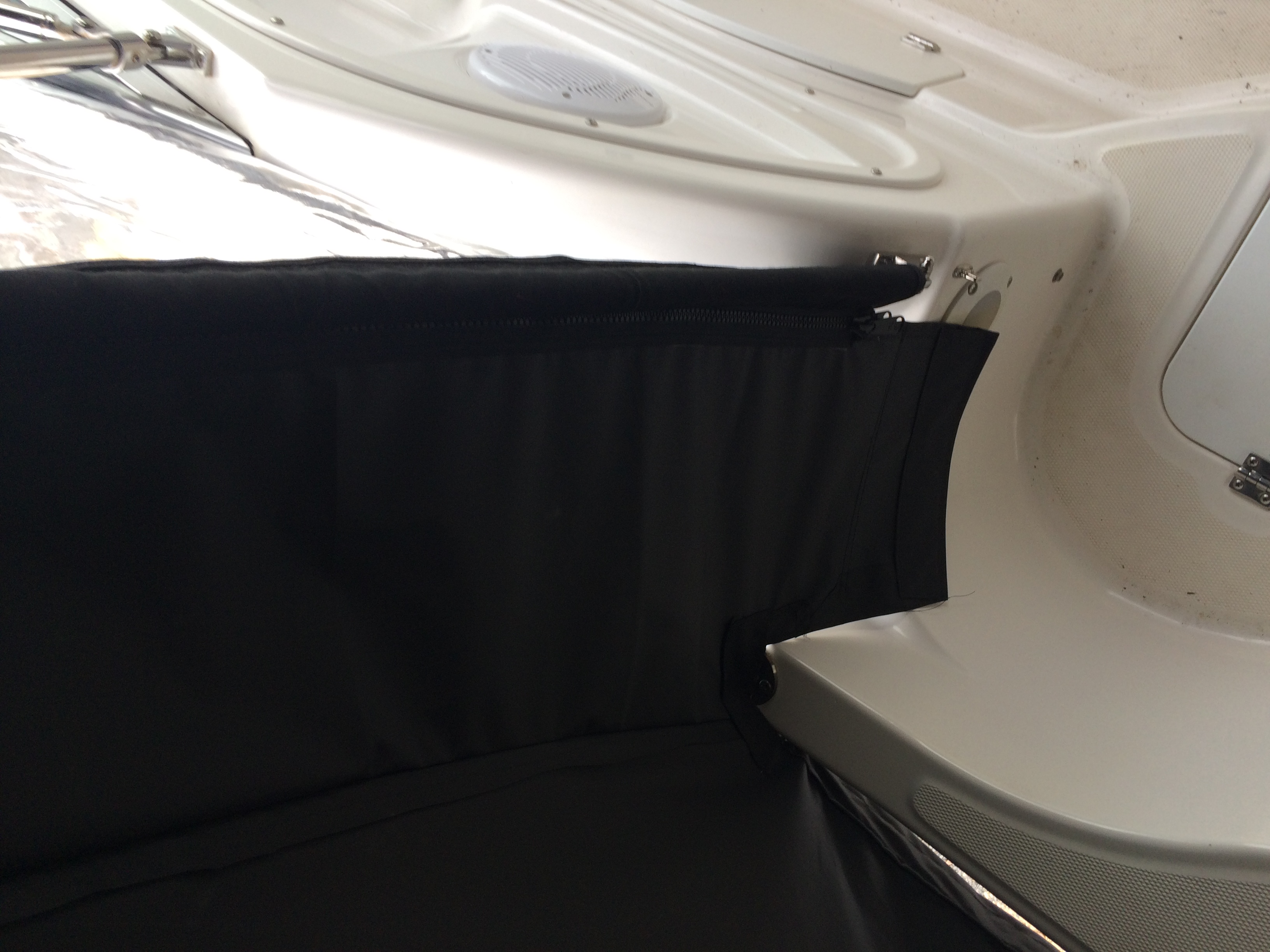

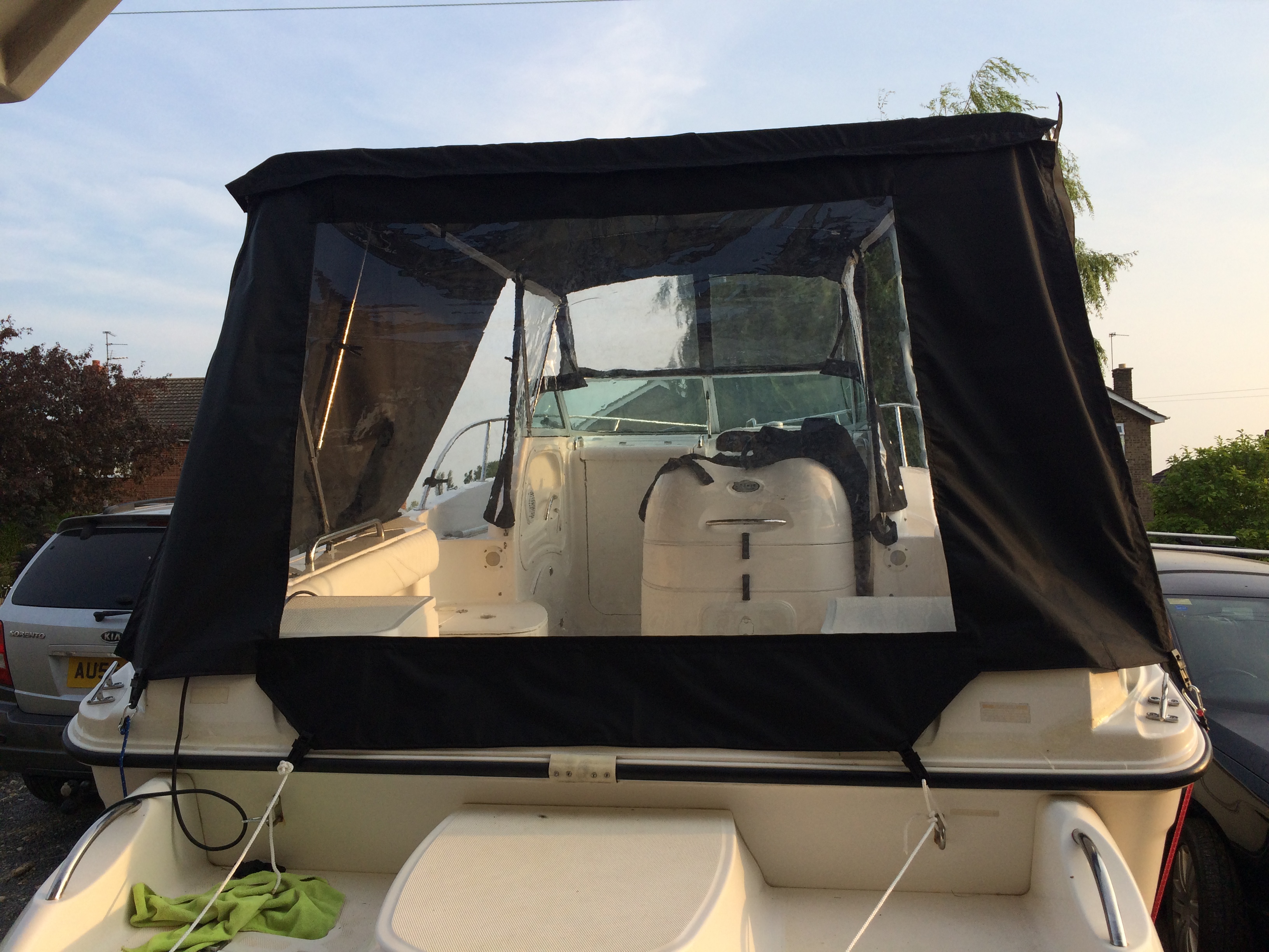

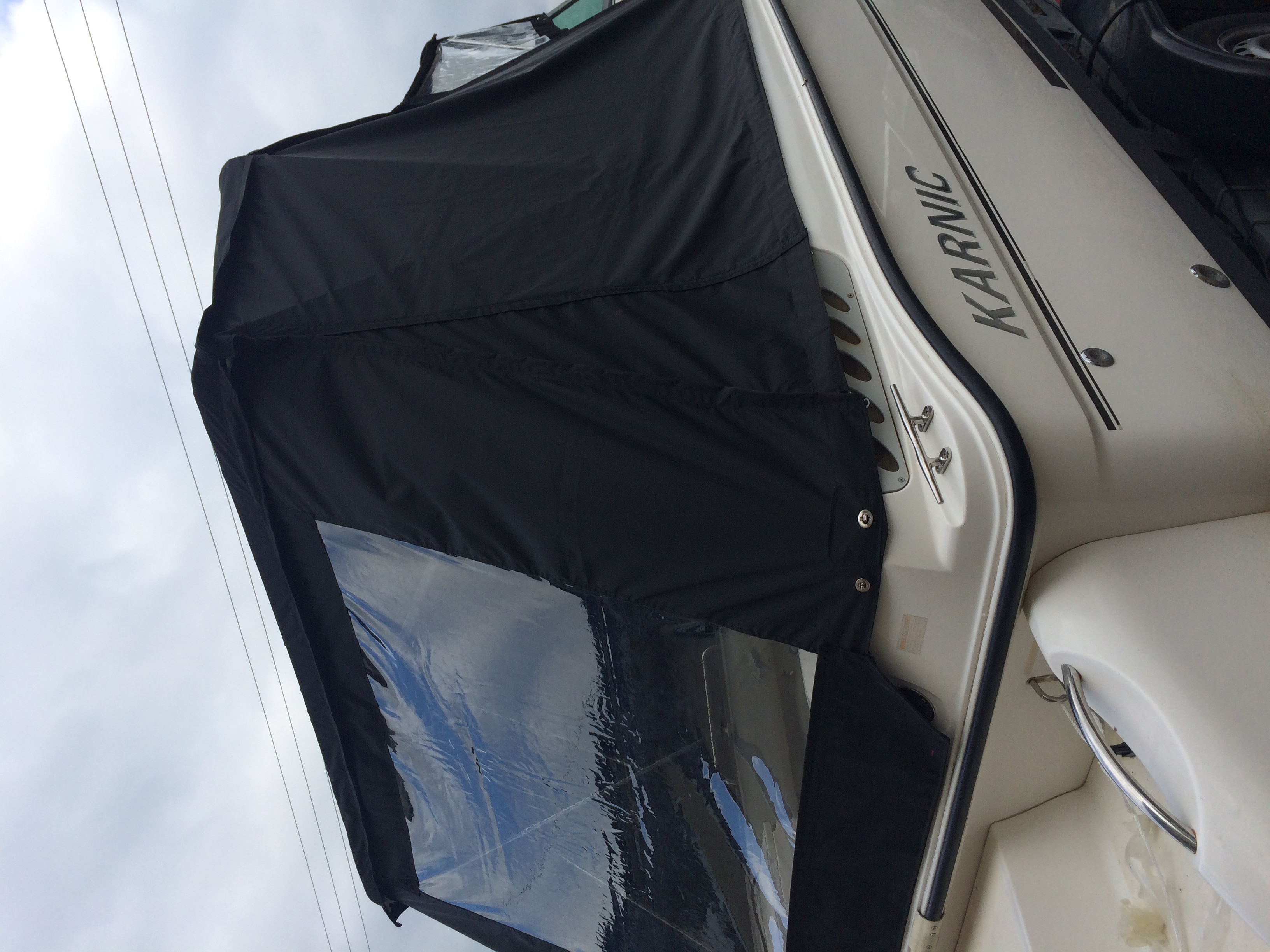

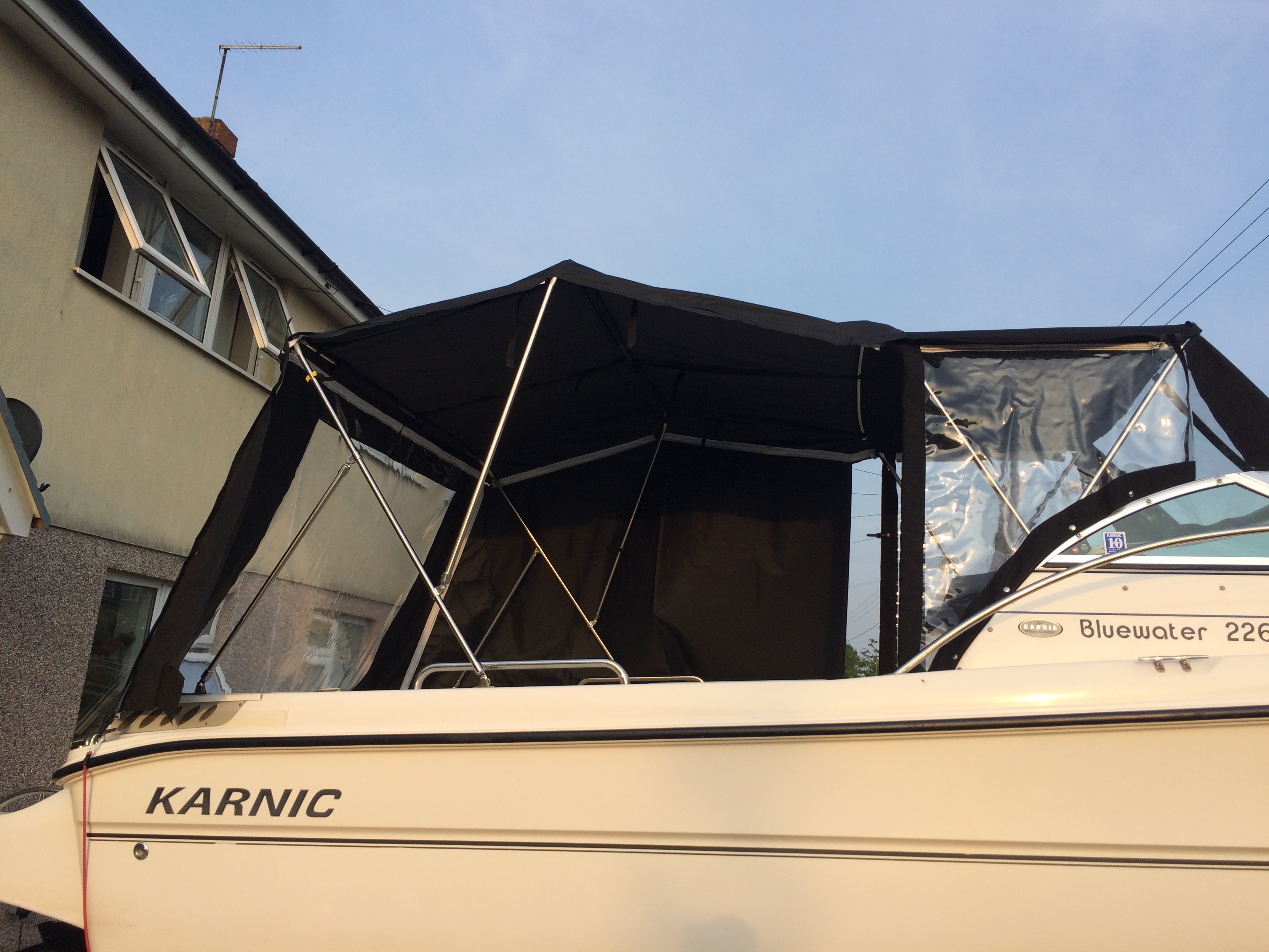

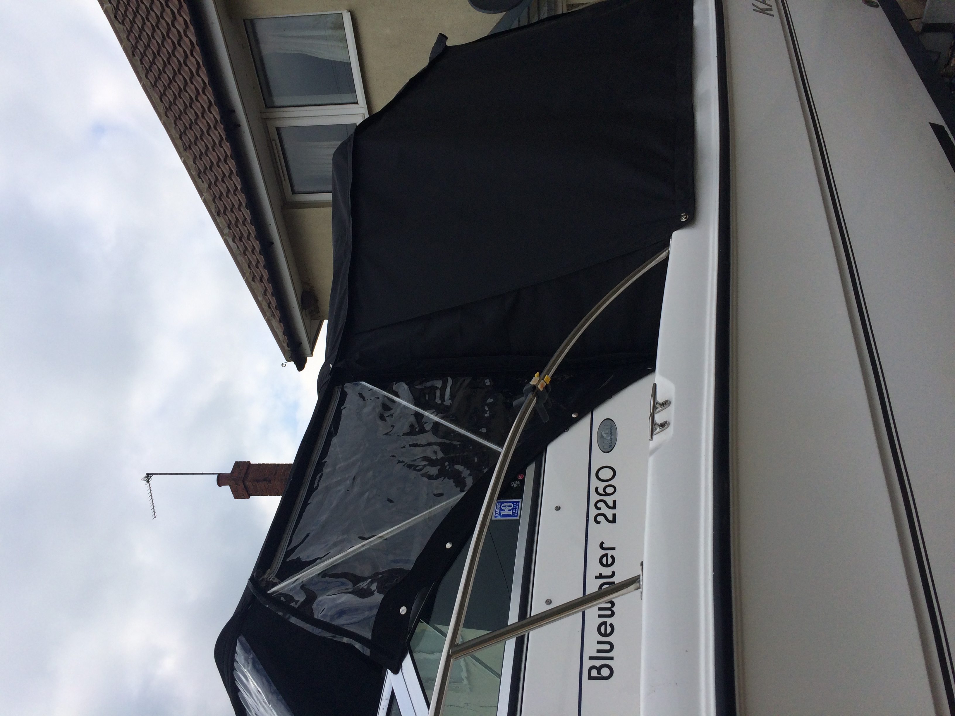

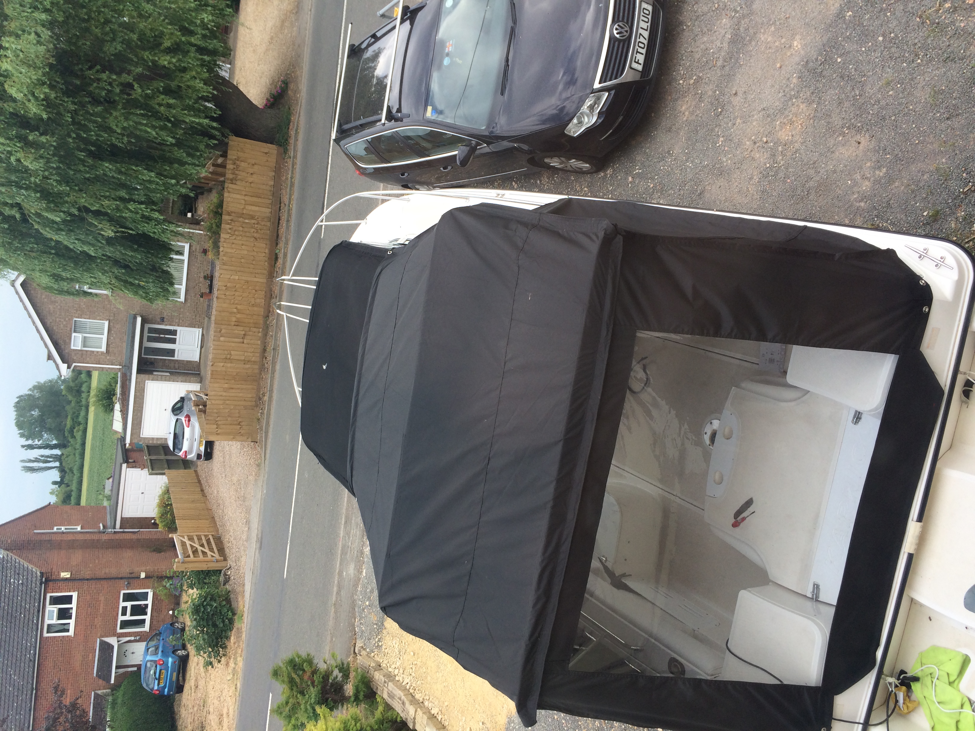

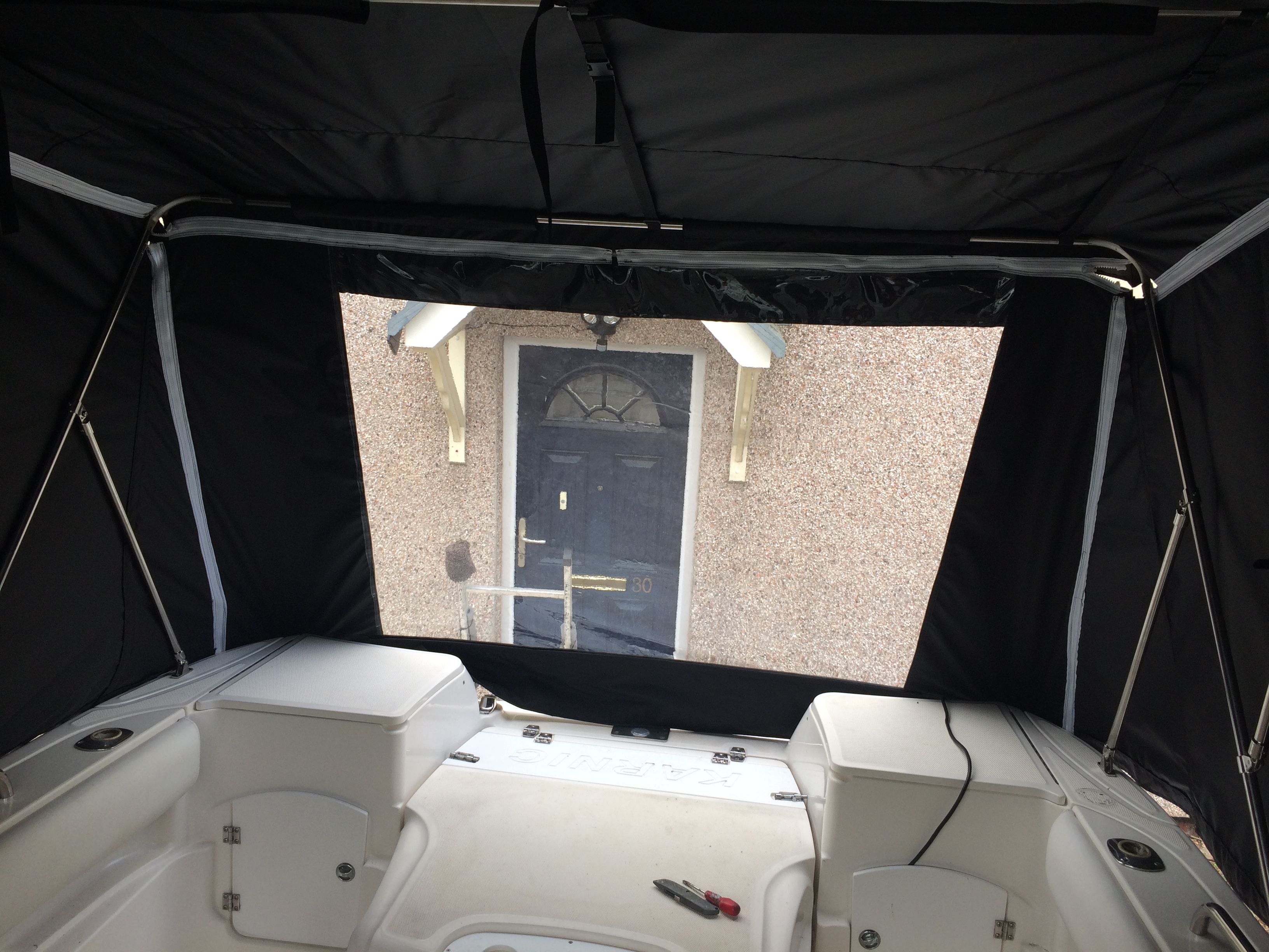

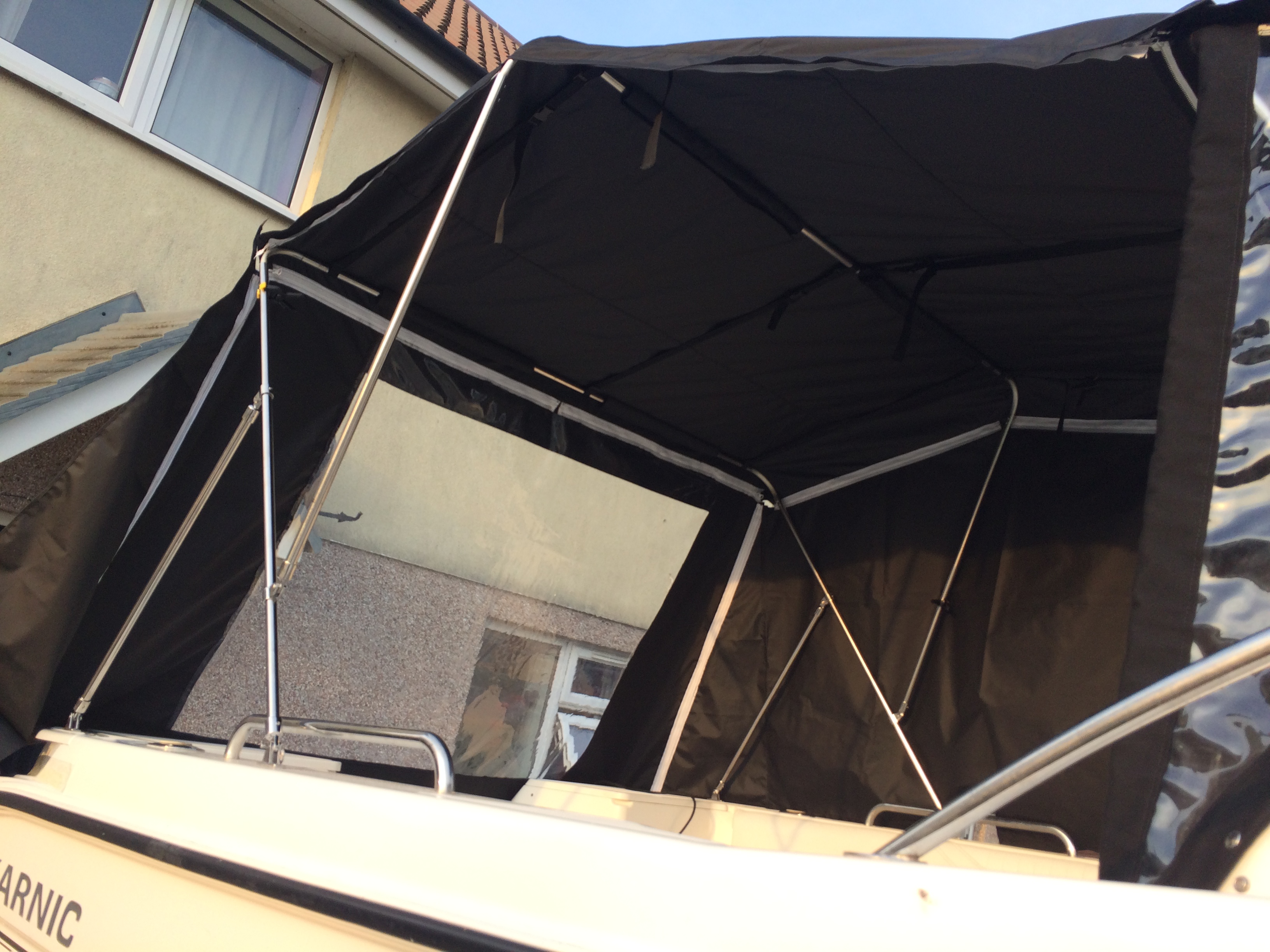

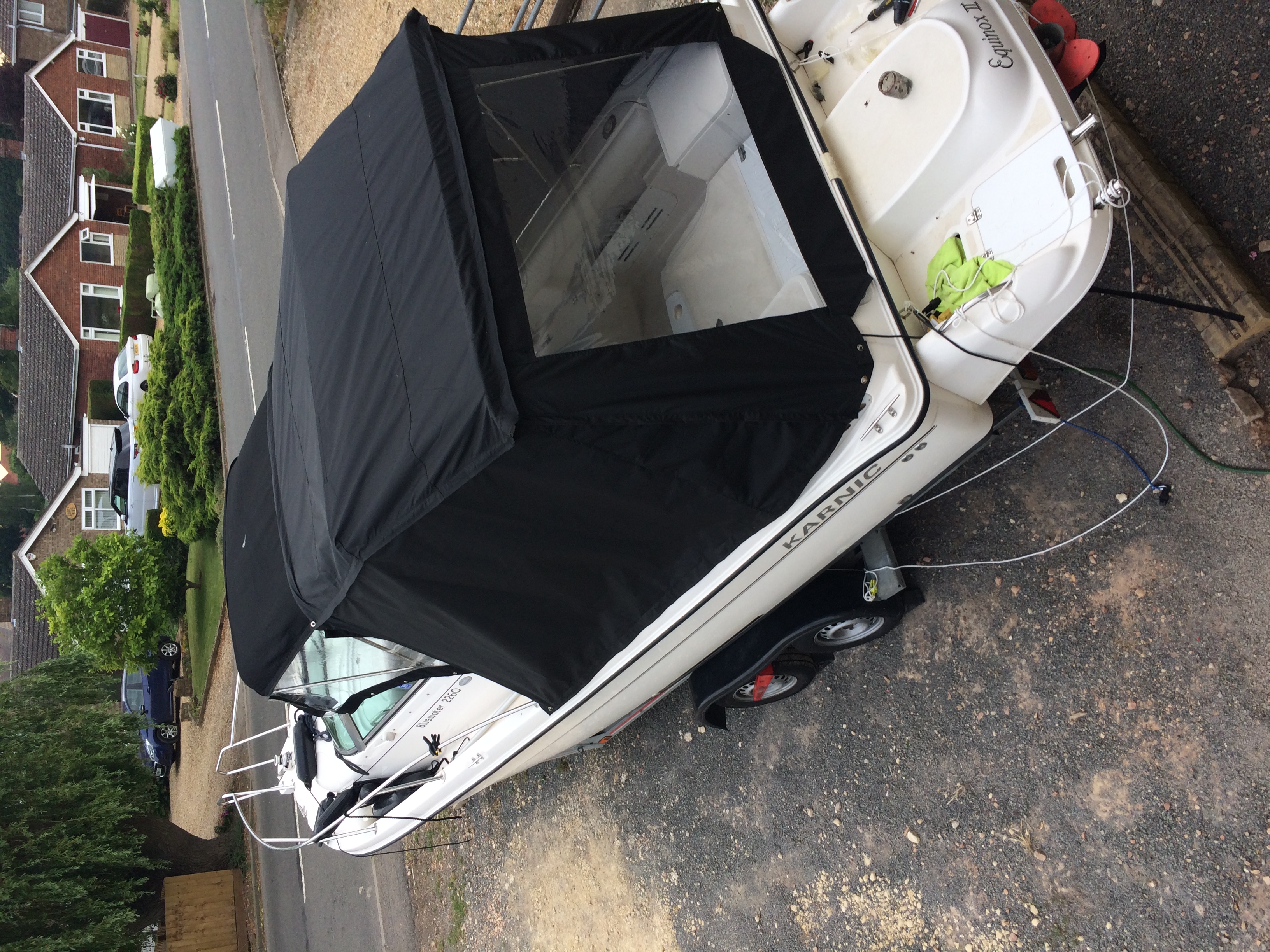

being a design oriented person it became easy to plan what panels went where to maximise material, joints hidden by poles, windows to save canvas etc. Joining to the existing canopy was a big pain, you'll see in the photos that the overall shape is square in the aft to a triangle in the cockpit esp with the walk around bow to make a door entry but avoiding a wind tunnel. The only 1 Karnic Ive seen with a deck Bimini was redesigned with a radar arch Aft to carry a cover and new cockpit cover so this was a truly 1 off design as we had nothing to copy after much Googling and Marina walks in the winter spring. Overall the cover went together very well, the machine handled me and the material well, ( a modern machine would have died Im told), working in a wind tunnel of Lincolnshire fenland was a big ball ache and required 4 hands most times on measuring (lesson 6 - do it indoors/barn etc if you can, FYI it is always Gf 4 to 5 up here with no shelter - no Geoff I still dont like it ;-)
In all not made in a professional way with patterns etc and I bet a pro would be laughing at the over stitching and suspect corners but this was a project to get a good looking cover at the absolute minimum cost. Ive only the SS poppers to fit now when they arrive from ebay next week. She is air tight, water tight, wind tight and folds away into a small Tesco bag (not the poles though) the cost - £500 max + we have a sewing machine to make new seats and summer overall cover. Time- well I was lucky that I wasnt working, when I was this project moved very slowly indeed on the down side Im stint with no prospect of working as a sewing machinist anytime soon :lol: :lol:
