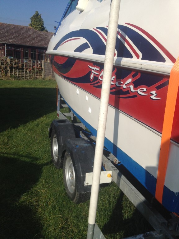

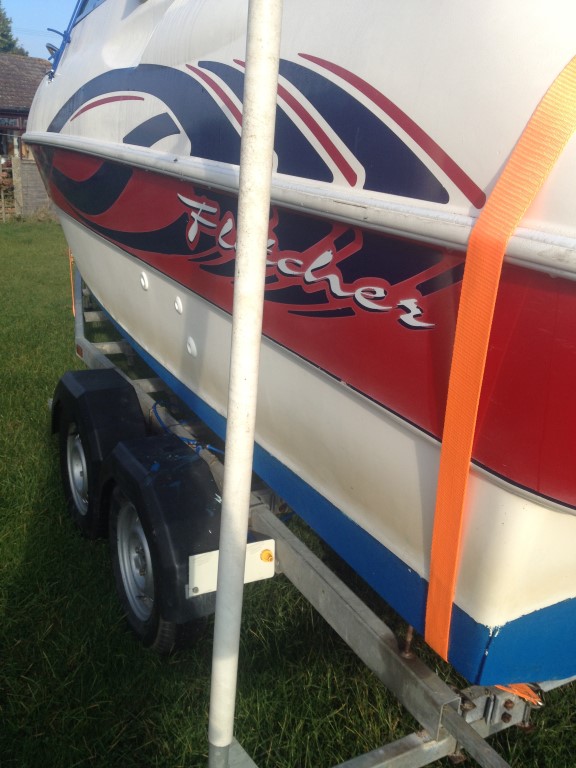

This is amazing stuff and very cheap. Look at the results of about 5 mins work easy peasey

by betty boop » 26 Oct 2016, 07:50
interesting - is that the brown staining gone alone the water line/white gel coat? Mines is the same won't come off with a polish but is it safe? thought I saw it was an aggressive powder cleaner so not sure how you used it.

by Ianfs » 26 Oct 2016, 08:16
Amazing, does it affect the gel coat at all?
by ColinR » 26 Oct 2016, 08:29
Shouldn't affect the gel. It's similar to Starbright hull cleaner.
by Bigplumbs » 26 Oct 2016, 21:26
Just mix with some warm water (about 15 % dry acid and 85 % water) and sponge on then wash off about 30 mins later. Some people have said to mix in a little wall paper paste to thicken it up a bit but I did not do this. I don't think it damages the boat at all. I think it just eats away the dirt
