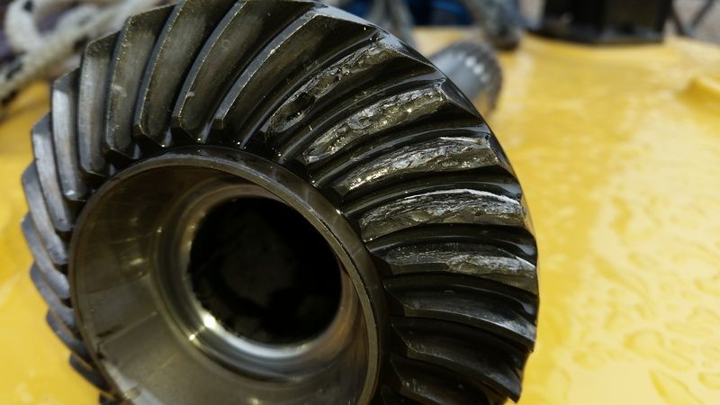

Vibration, shudder etc could be a myriad of problems. Start eliminating them piecemeal beginning with a new prop. Firstly I love stainless steel props, but really they are a daft idea. They will accelerate galvanic corrosion, they are too strong and will transfer any propstrike into the gearbox and cause massive damage to the gearbox if the strike has enough impetus behind it. (I've destroyed 3 boxes in 2 years). They are horrendously expensive by comparison. My advice is forget the bling and go ali. Match it to your boat.
