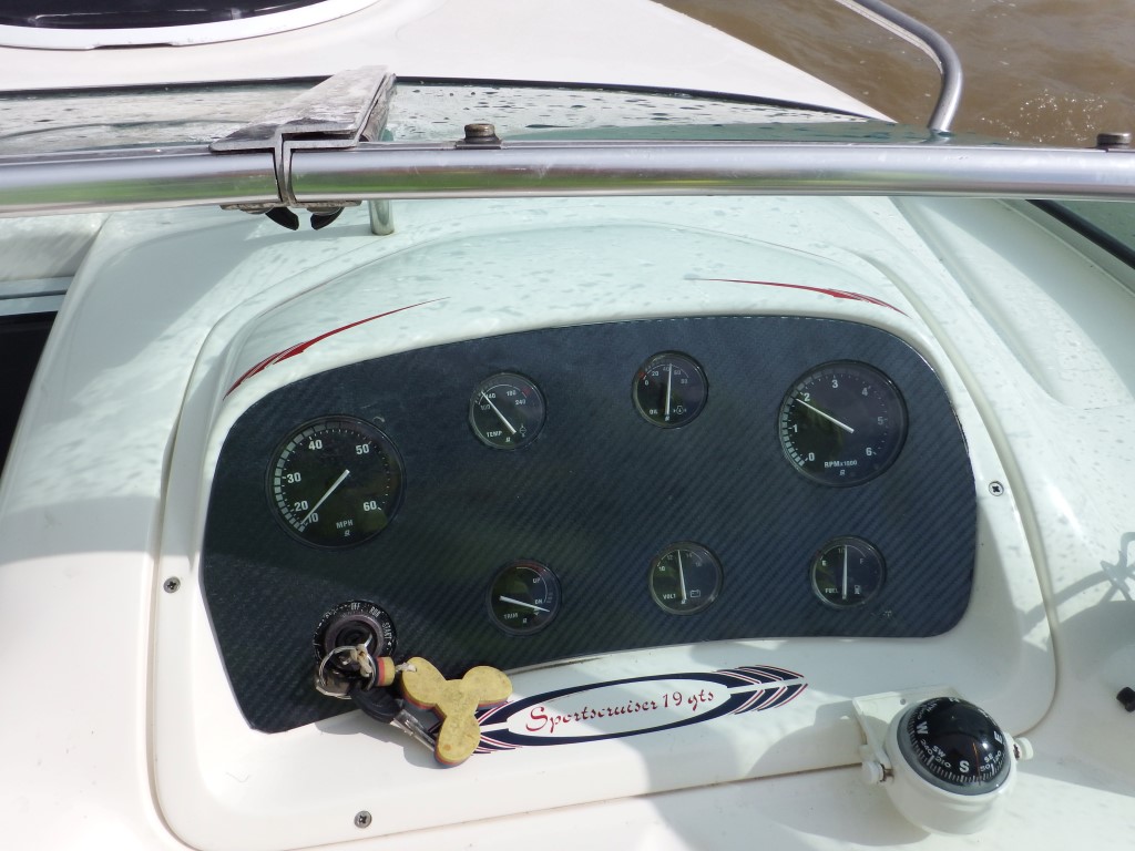

Had a nice day out today in the Fletcher GTS but the engine temp seemed to be odd. This is only my second outing so I don't know what to expect. The engine as most of you know is a mercruiser 3 ltr. When I was just pootleing along at very low revs the temp was at the bottom of the gauge (This makes me think the stat is jammed open) Then after a while at about 4500 revs (Sort of flat out) it got to about 180 degrees. The impeller is good I think. DO you think I should replace the Thermostat or are these sort of temps normal

Doesn't sound normal to me. If it was a car I would say thermostat for sure. I'm sure an engine techy will be along shortly
by Gazjen » 30 Apr 2016, 22:36
Yea sounds like a stuck open stat, or removed and if it's been removed you need to figure out why.

I don't think it is removed because I am sure the first few times I ran the engine on water it held at about 140 degrees. I will get one from repower marine. Provided the sleeve that holds it in place is is not seized in I don't think it is too bad a job to replace

In that case, it is my experience that they do tend to run cool at low power output but hotter on higher power than those with intercoolers. Why this should be so is a matter of lengthy debate and you'd think it would all be controlled by the thermostat, but it just isn't. Particularly if the boat has been used in salt water and has a few years on the clock. By all means change the thermostat, it's a simple quick job, but don't be distraught if it doesn't cure it. My 3.0 GL worried be endlessly at first, but she never boiled over.
Some argue that salt water corrosion builds up in the cooling ducts creating slower flow and insulation. This may be true, but cast iron doesn't rust through (just look at all the Victorian piers, they have a self galvanising effect). Running hotter causes some owners to have a knee jerk reaction and remove the thermostat altogether. This isn't really advisable. So long as the water isn't boiling the engines prefer it hotter.
