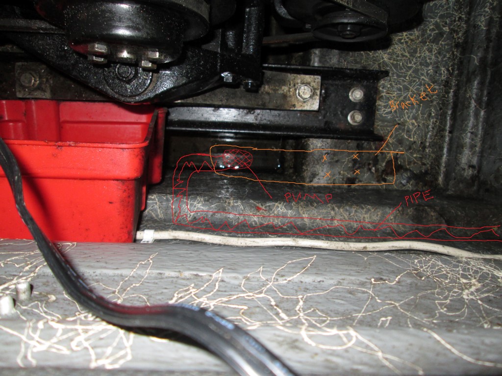

I have been at the boat all day and have I think located the wires to the Pump but they are incredibly difficult to get at. I had power to the pump again today for ages as I did yesterday and it did not get in the slightest bit warm, as opposed to yesterday when it got very hot. I think we have possible blown a fuse or burnt something out which actually is good. I will leave all the old pump etc in situ as it is in my view next to impossible to remove
I have now decided to put a smaller (750GPH) new pump in the bilge at a reasonably accessible point to the front of the engine with a switch in the engine bay and no float switch. I will run a new waste through the port locker and cable tie it to the self draining pipe from the cockpit scuffers and out a new hole just above this self draining hole.
My theory is that not much water will get in the bilge but if it does I will just lift the engine access from time to time look for water and if there is any I will just throw the switch in the engine compartment for a while. The switch at the helm position will then be redundant. Working in that engine bay is no fun.

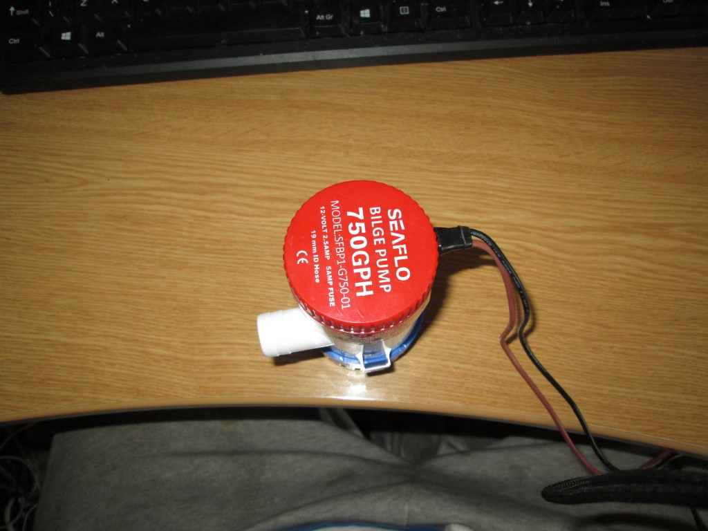

Here is the plan. This pic is at the front of the engine down into the bilge bay. And a pic of the little pump I will use

You make an interesting point and you can get the same pump I have at 1100 gal per hour. I think I will set this up as the main pump as my drawing and have the smaller one on board taped to the end of a stick with crock clips on the cable ends to quickly connect to a battery that way I can use it as a back up or a second pump if I did take on a lot of water only £11 to buy
http://www.ebay.co.uk/itm/12V-1100GPH-S ... SwzhVWqhRl
by Bigplumbs » 29 Feb 2016, 07:27
Just looked at the specs and the outlet pipe on that 1100 pump is 29 mm as opposed to 20 (whicich is all the pipe and outlet I have bought) so wont fit what I want to do. I have therefore bought a second 750 gph pump. I am going to position a second battery somewhere in the boat so could use this in an emergency. I think with the self draining cockpit etc this will be ok
Also I tested the 750 pump in the bath (My wife was actually in it at the time) and it actually pushed water very quickly. The bilge will only hold about 200 ltres totally full and in theory this pump should empty that amount in 3 - 4 minutes
