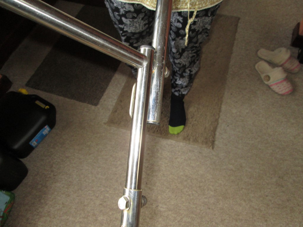

Extra length (4 needed)
IMG_0307 (Medium).JPG (153.84 KiB) Viewed 15124 times

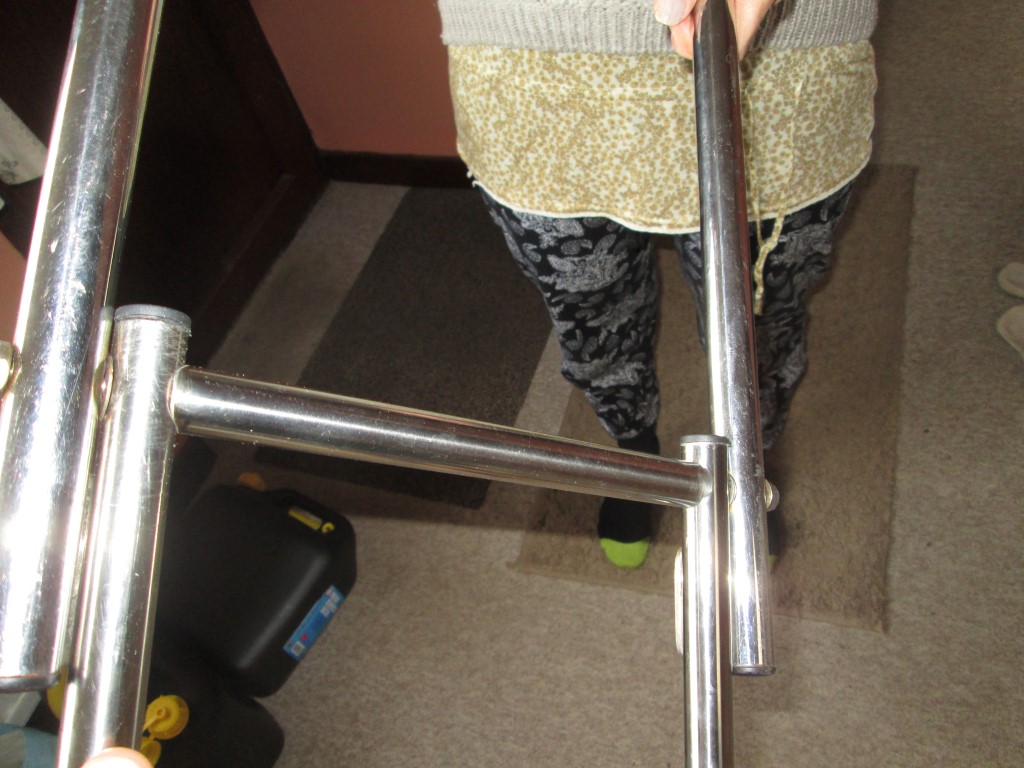

Additional step
IMG_0306 (Medium).JPG (176.85 KiB) Viewed 15124 times

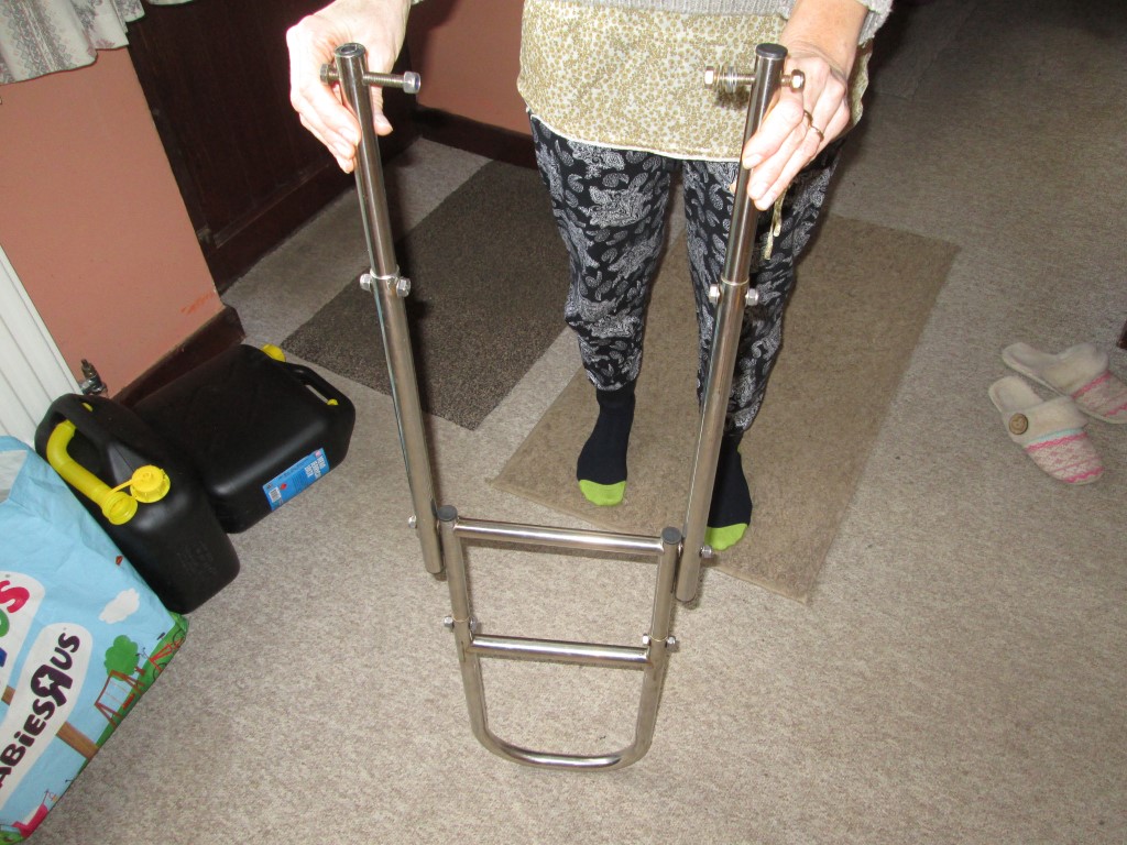

The whole bit off the boat. One section remains on the boat
IMG_0305 (Medium).JPG (227.69 KiB) Viewed 15124 times

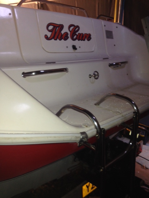

Ladder 2.jpg (130.26 KiB) Viewed 15085 times
Ladder and handle.jpg (82.64 KiB) Viewed 15085 times
