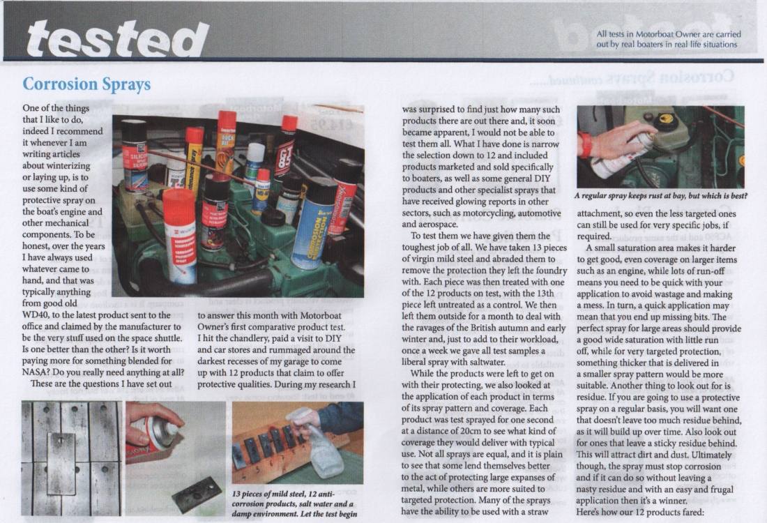

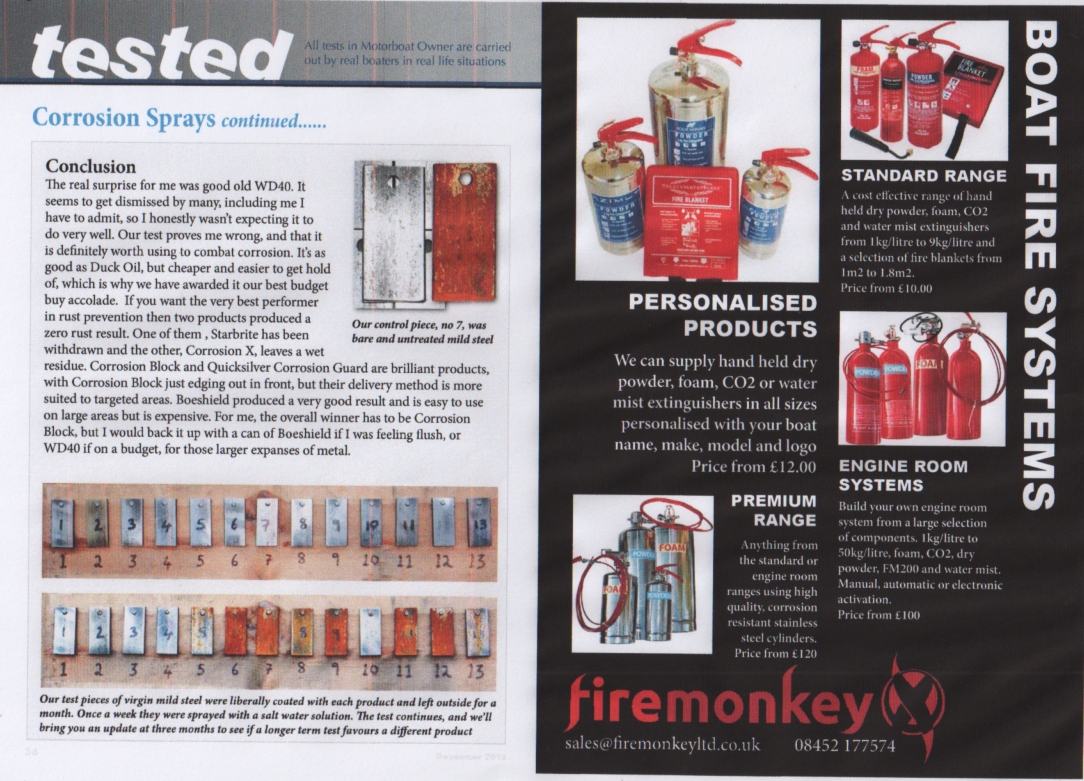

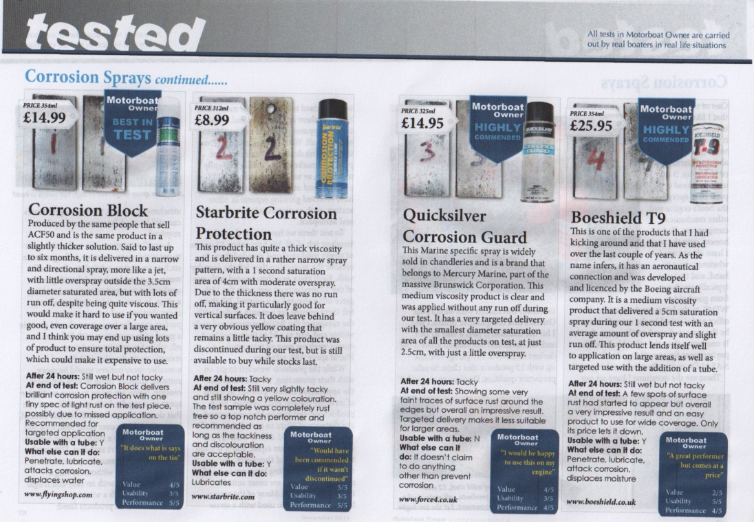

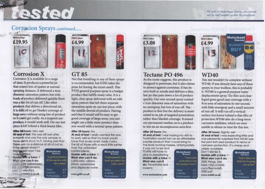

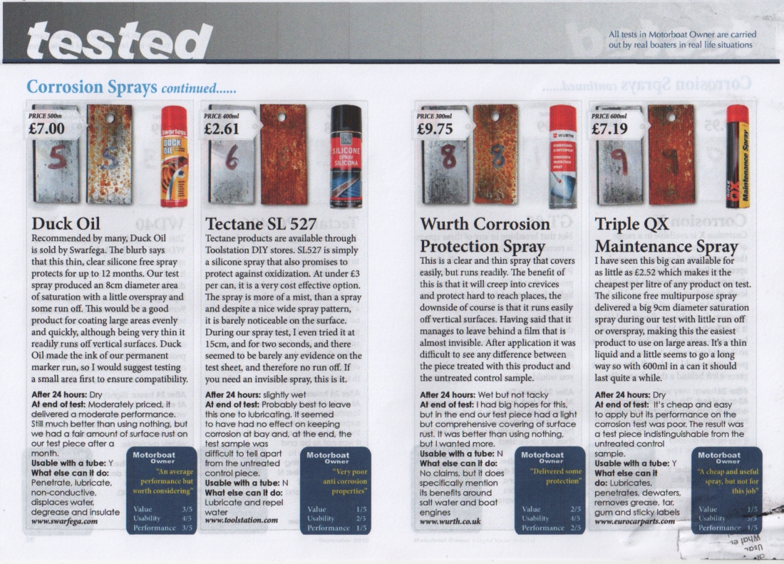

I think you've done a pretty good job, I'd like to know the outcome of keeping the hubs in plastic bags.
In the meantime, you may have already seen this but for those that haven't, this is a good article from this months Motorboat Owner Magazine......
Corrosion sprays001.jpg (737.47 KiB) Viewed 14413 times
Corrosion sprays002.jpg (744.32 KiB) Viewed 14413 times
Corrosion sprays003.jpg (770.37 KiB) Viewed 14413 times
Corrosion sprays004.jpg (774.65 KiB) Viewed 14413 times
Corrosion sprays005.jpg (665.32 KiB) Viewed 14413 times

What? No ACF50 on that test? It's lost credibility :P I swear by it, you should see what salt road grit does to motorcycle ali rims and magnesium alloys.
As for sea water vs Road Salt I can't be sure there is much in it.
by Ianfs » 02 Dec 2015, 12:28
What? No ACF50 on that test? It's lost credibility I swear by it
The product which came first, called Corrosion Block, as it says in the write up, is made by the same people as ACF50 and is the same product, but slightly thicker. :mrgreen:
by BruceK » 02 Dec 2015, 14:57
Credability restored :D
