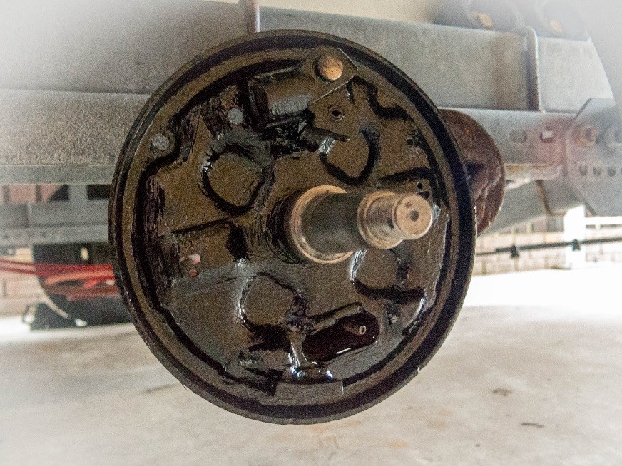

#1 From new
Paint the back plate front & rear, and metallic part of shoes & drum with 2-part epoxy paint. Obviously not putting paint on stub axle mating surfaces, or where friction shoes touch the drum.
As well as enhancing protection, makes annual clean for service much easier.

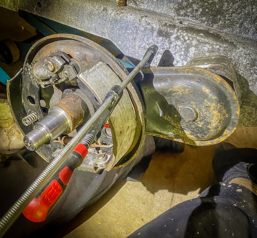

I have had many trailers with Al-Ko brakes and they were all difficult to install the plate spring on one side …. This is the side which is obstructed by the suspension swing arm. On the SBS trailers, this is very difficult, as you cannot even get a finger between the gap.
Here is a method I figured out that works.
1.use a wood work clamp, one part behind the swing arm, the other on the face of the spring . Line spring so the ‘hook’ faces vertically upwards.
clamp
tape

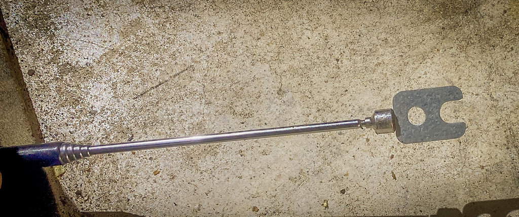

2.Use a telescopic magnet to hold the plate ‘end on’
Position into place from above, then slowly release clamp, closing Spring hook into the appropriate holes in the plate.
Using a needle nose pliers, at the face of spring grab the central rod and rotate 1/4 turn to put sori g plate into correct location (horseshoe facing out)
This may sound convoluted but takes less than 3 mins …. Having spent a great deal of time trying to get plate on otherwise this is very quick, and saves a lot of swearing as you keep having to find & pick the clip up.
mag tool
