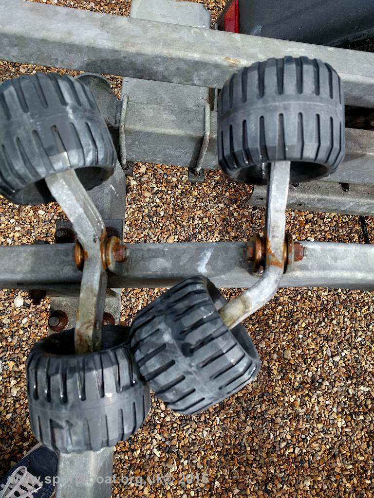

mlines wrote:One of the rollers is bent.
by Ianfs » 27 Mar 2016, 19:09
Looks like two roller shafts are bent. Do you think it may be the stepped hull has caught them? Is it worth a check on the hull to make sure there is no damage?
by mlines » 27 Mar 2016, 19:57
Yes its the step and we do get chipped GRP.
There is a large wheel in front of the rollers but it does not stop them getting in the way on shallow angle slipways

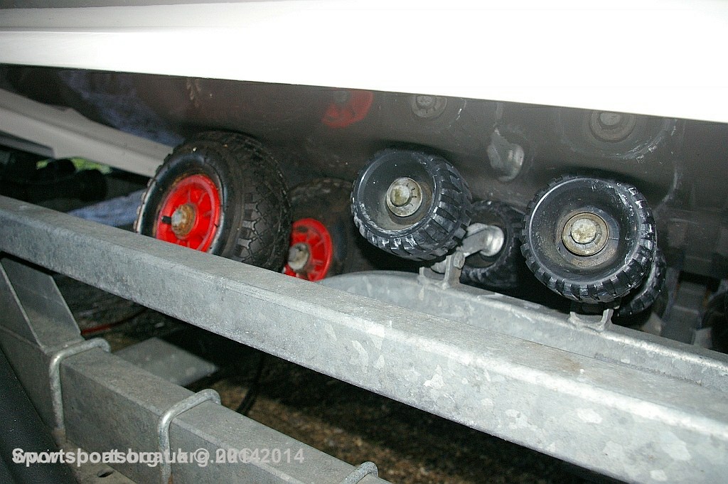

by Gazjen » 28 Mar 2016, 01:10
Doesn't look like the red wheels are doing anything. They don't look compressed at all. I had them on mine when I brought the trailer but removed them and altered the roller set up so they were away from the step.
Gazjen
Posts: 106
Joined: 19 Jun 2015, 02:13
by mlines » 28 Mar 2016, 08:49
I thought the red wheels only came into use when the step comes over them? Giving a larger diameter surface to ride over?
How did you move the rollers away from the step? The step is full hull width so it has to go over the rollers somehow?
