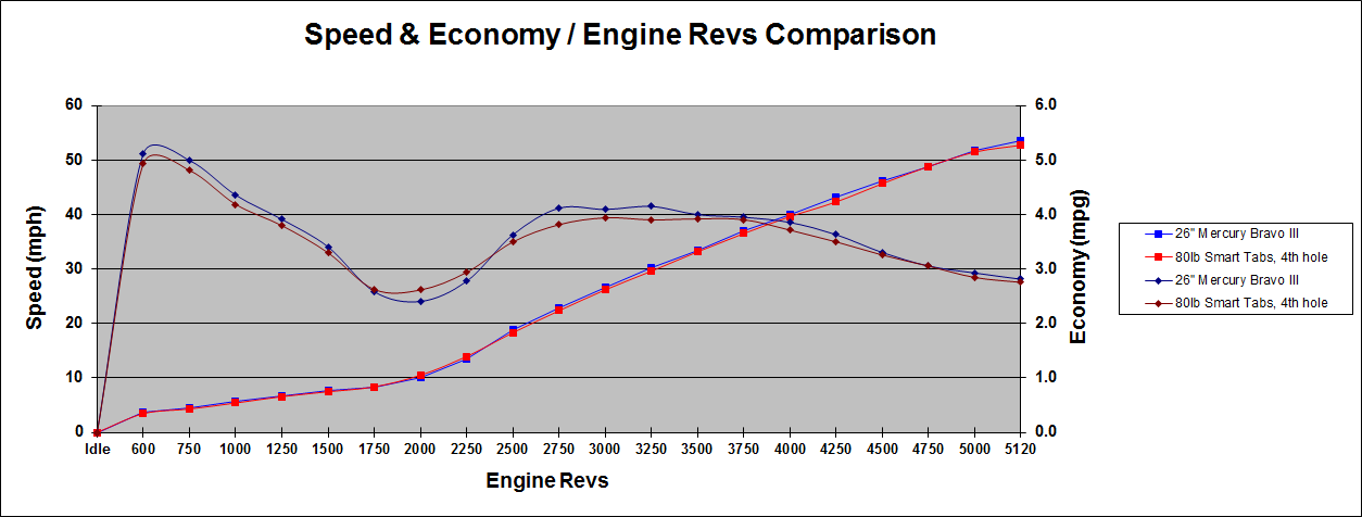

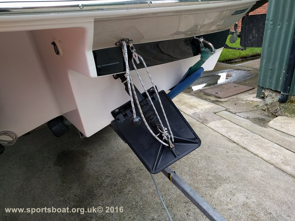

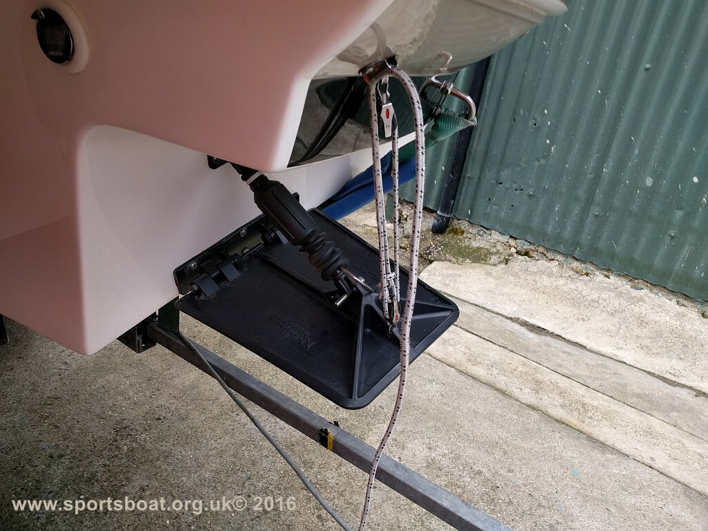

Mark (the previous owner of our boat) fitted trim tabs. He overcame the possible reduction in top end issue by having some pull up cords. Now clearly these are NOT operated whilst in motion but you change them when you want to do water sports or when you want to go fast.
The chart shows that there is very small differences on our 300HP Regal 2250. As you come on the plane with the tabs in use the boat is slightly more economic which you would expect as it planes better. Then as you approach top speed it becomes very slightly less economic as it drags the tabs.
The effect is visible around 1700 -2000 revs where the lines swap over

have you used them in the down position on the river? Im interested in what Gaz said about better slow handling, As Ive said before my Smart tabs are in a box waiting to be sold but yo've sparked interest with the pulley system in the photo, if theres a significant improvement on slow speed handling then may be I could pull them clear for the high speed stuff. For those not in the know Smart Tabs don't compatible with the back of an MX1800 Maxum, or at least they do just fit but create a very unstable bow rise at speed.
