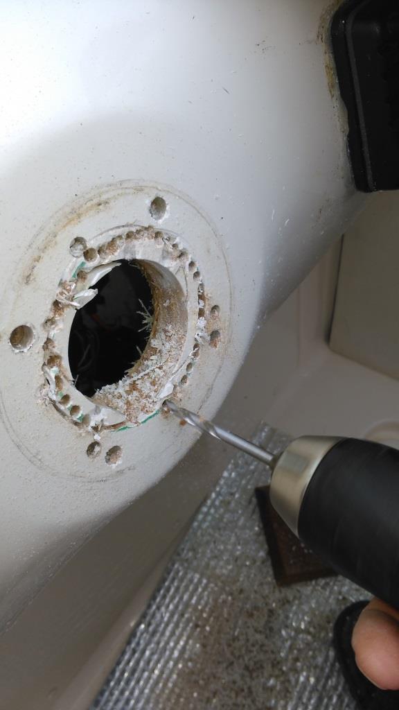

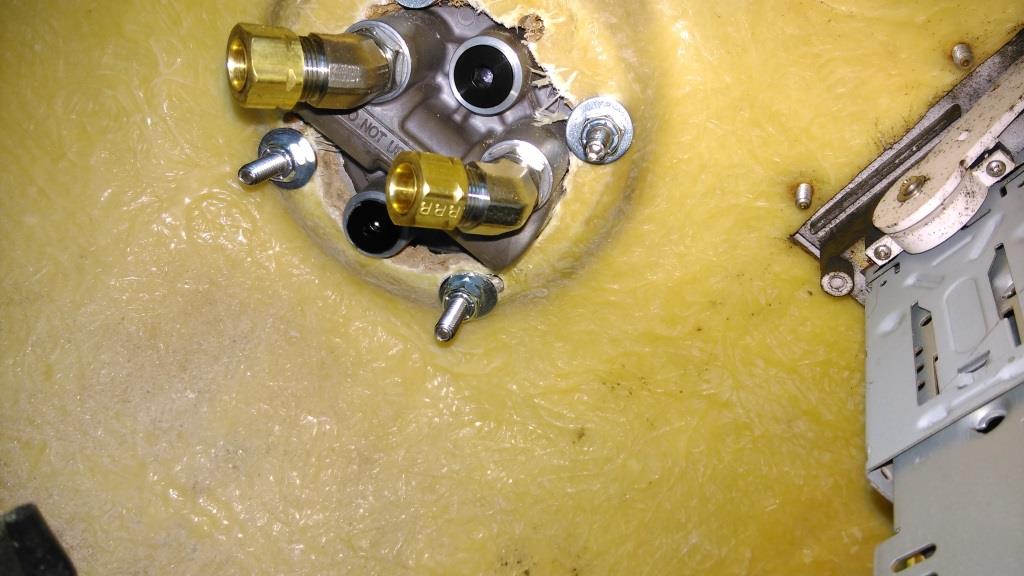

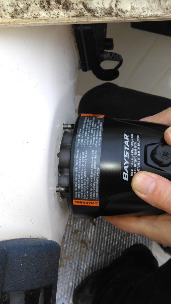

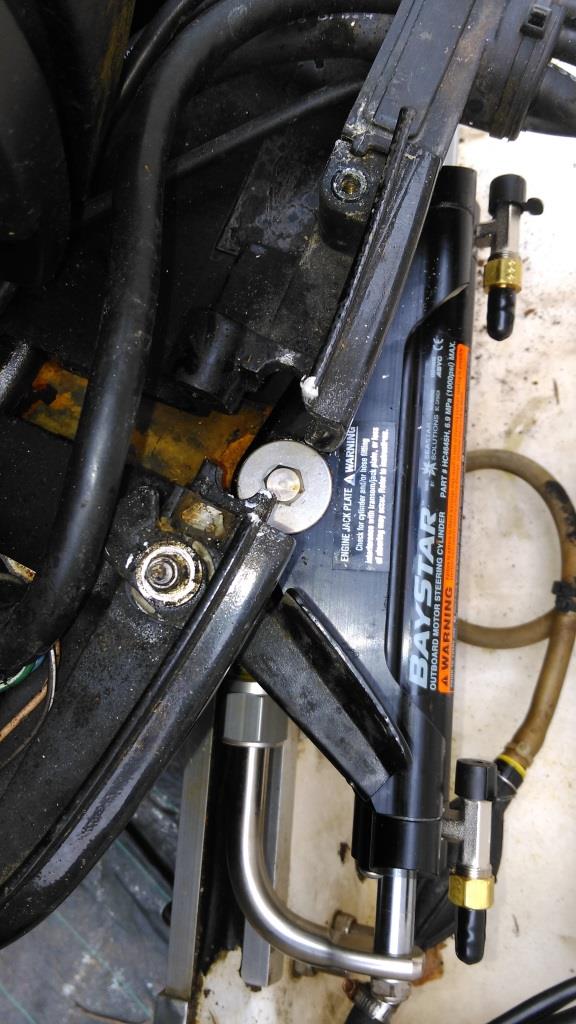

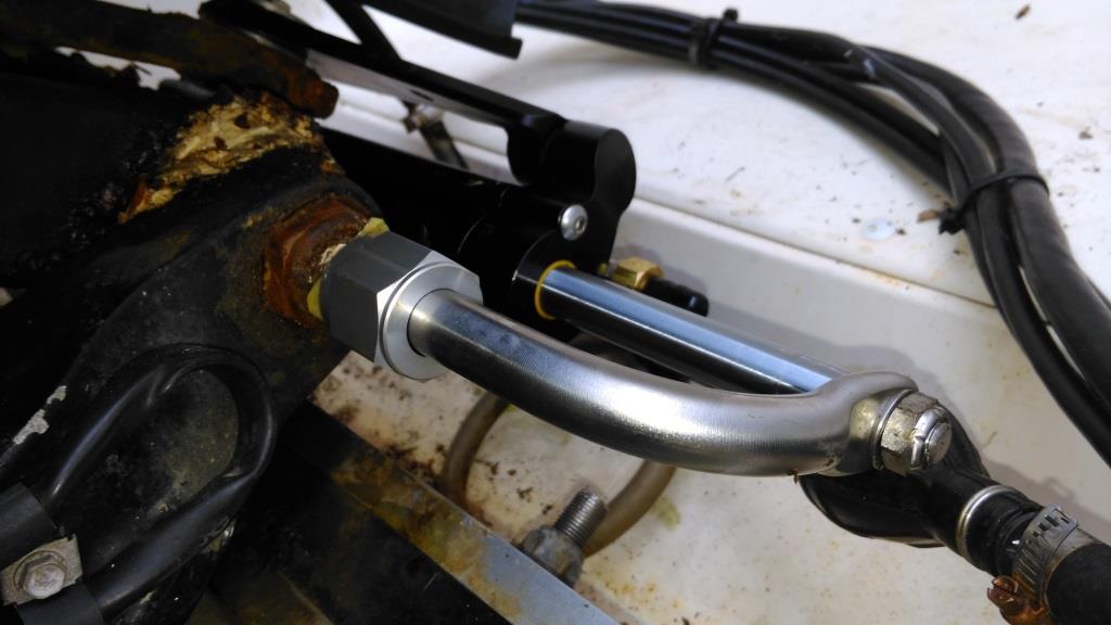

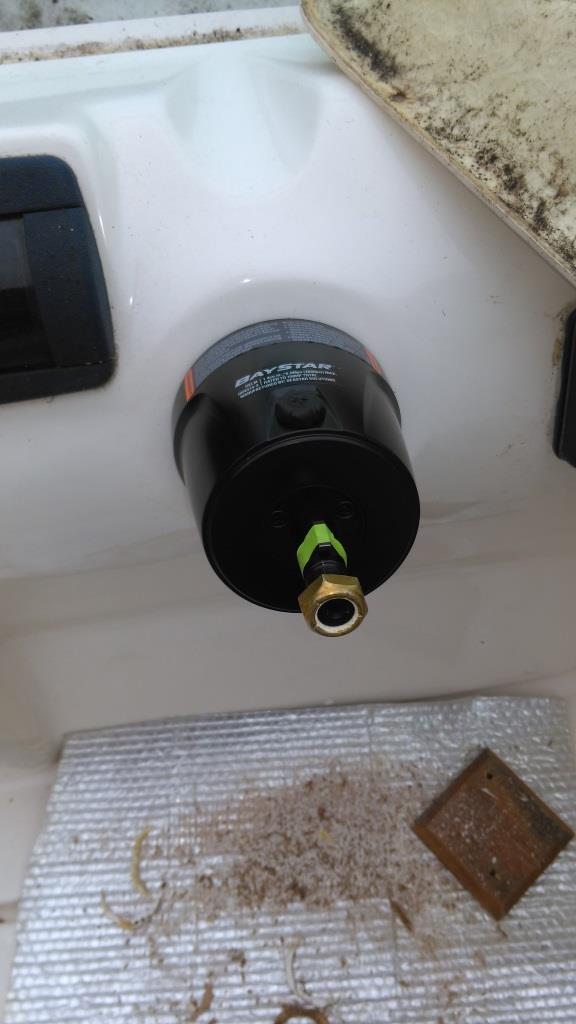

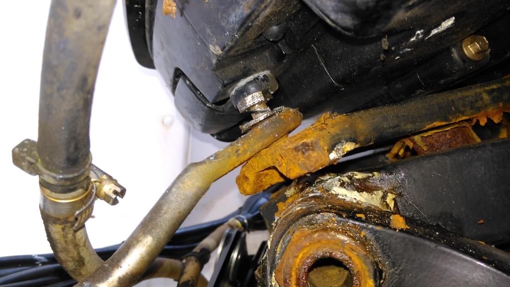

Steering has been a problem with Hot Property since I bought her so I have bitten the bullet and installed hydraulic steering.
Not a 5 minute job!
few pics below that show various stages of the installation, I had to open up the clamshell casing on the engine to install the vital bolt that holds the ram onto the engine.
All I have left to do is secure the pipes in the rear engine well so that they don't pull the fittings when hard to port or starboard.
The end result is brilliant - about 1/3rd of the effort required to turn the engine and smooth to boot.
Just a bit of cleaning, quick lick of antifoul and then she's ready to launch.
