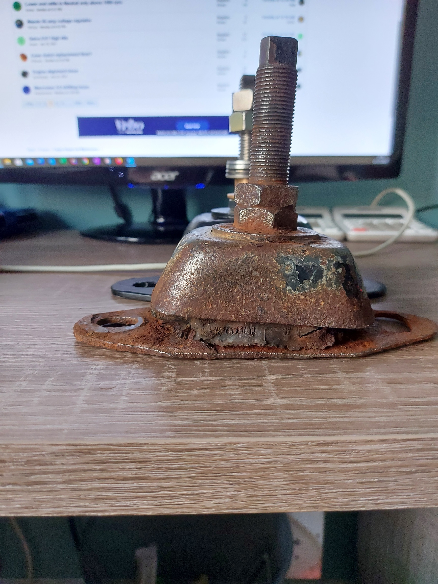

I bought my boat back from the boatyard last week to give it a good service and clean up from Winter rubbish and discovered the engine mounts had finally given up. My goodness me what, a palaver in establishing which type it should have and then lack or supplies. In the end, instead (rightly or wrongly) I bought 2 mounts from
AV Engine Mounts
They are supposed to be Marine Mounts but it never ceases to amaze me that anything with a marine title is only protected by a Zinc coating. Don't get me wrong, they are very well made and you can get them with different strengths. So I coated them with an Epoxy paint and sprayed them black to match the engine.
I've already been round all the bolts to see if the move and luckily so far I'm managed to get them all to move.
I'll let you know how I get on changing them.

Here are some photos of the old mounts in place......

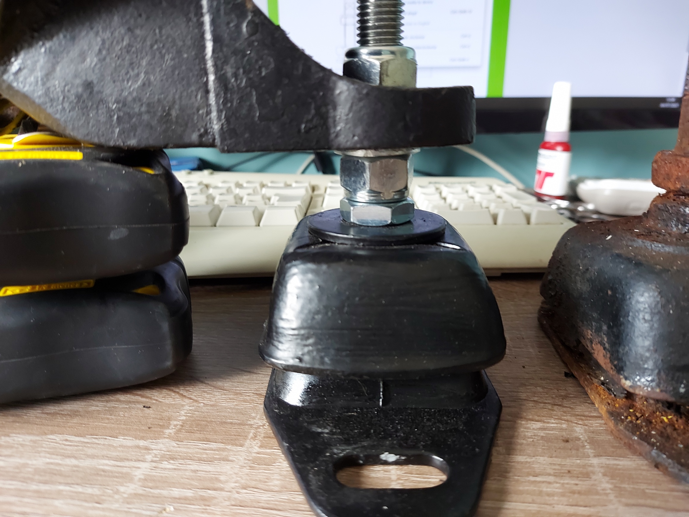

Trying to get some new mounts was a challenge as most places were "Out Of Stock". I did find some at Repower Marine but I was advised their flex was a little weak for the engine and the weight capacity was a little low, but as I said earlier, I found some.

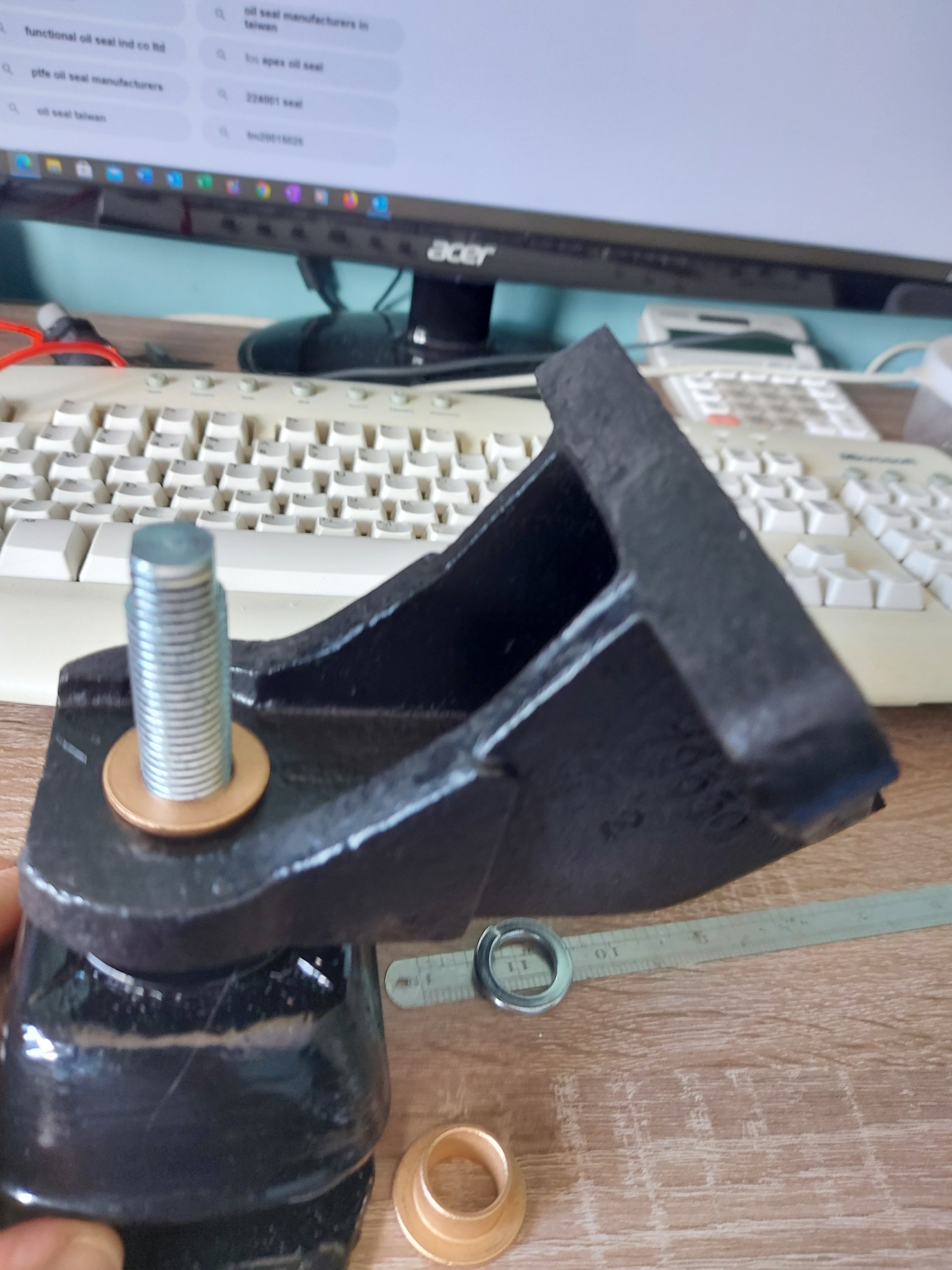

The mounts from AV came with 16mm ordinary zinc coated height adjusters, washers and nuts, so I bought some 16mm Stainless Rod, Nuts and washers from Sea Screw and fitted these. Cut the rod to size with a hacksaw and took some of the thread off with a Dremel Cutter to get a spanner on to tighten. The old mounts had ¾” adjusters (I said earlier they were ½” but that was the bolts holding the mounts to the boat mounts) with fine threads and the 16mm were rattling in the hole of the mount brackets, so I thought rather than have the work loose I found some Bronze Flanged Sleeve of the exact sizes. The height adjusters from AV mounts came with self locking nuts but were way too big as the Mercruiser mounts were fitted with half nuts. I was concerned that half nuts on an ordinary thread would not be strong enough but consulted with Gareth Jennison (Gazjen) who set my mind at ease, thanks Gaz.
New mount painted with Epoxy paint then covered with High Temp Plastikote....
Bronze inserts in place

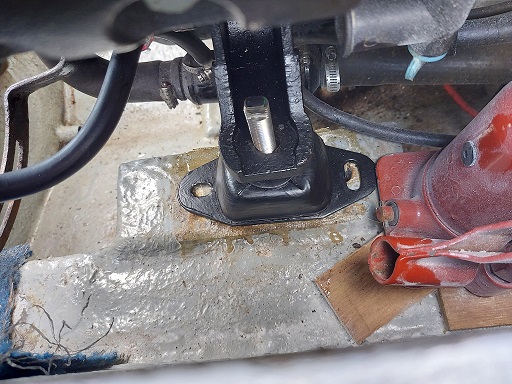

I removed the Stern Drive and supported the engine by the manifolds with a bottle jack on one side and my wife’s Yaris scissor jack on the other side. :mrgreen:

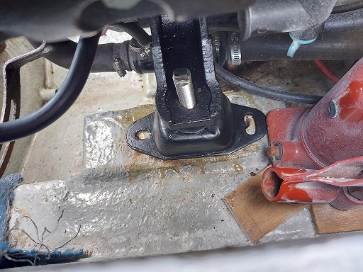

I dry fitted them, the Starboard mount lined up exactly with the holes in the boat mount support, but the Port mount holes were way out. Yet another setback and what to do, possible rebuild and boat mount modification? I posted on iBoats to ask about their thoughts and was advised it was probably installed originally with a 4x2 because they cut the holes in the wrong place, you naturally don’t like to think they would do this at the factory but it was a logical shout. After figuring it out I bought a plug cutter and filled the front hole with an oak plug and epoxy, the rear hole wasn’t far out so it only needed a little adjustment. Whilst doing this I figured I ought to check alignment each time and as I had only lifted the engine sufficiently to remove the mounts when I lowered it back on the new mounts, it wasn’t far out.
New mounts dry fitted
Not aligning with holes B.jpg (99.88 KiB) Viewed 49191 times
Here's why the new mount wouldn't fit, the old one had a set in it just enough to fit the holes, definitely had been forced into place.....
Now, I had to work out how to get a drill in under the Exhaust manifold as there was no room, possibly about 15cm. I settled on an angled drill bit and put in a 13mm drill bit to take the ½” retaining bolts.
After everything was painted and ready the job was completed and the engine aligned once more. I did find that turning the engine during the alignment process that the tool slipped in easier one way but after a 180° engine rotation it was stiffer but not too much, so I refitted the Stern drive. I added some new fuel and she turned over but wouldn’t start, so I added a bit more and she still didn’t start. I thought the best thing to do was to pour a little fuel down the carb intakes to see if it was fuel starvation and she fired immediately. After a few days I tried again and the same thing happened but fired after pouring some fuel into the carb. Mercruiser engines have an accelerator piston so I think this may be the problem, something to look at this week.
