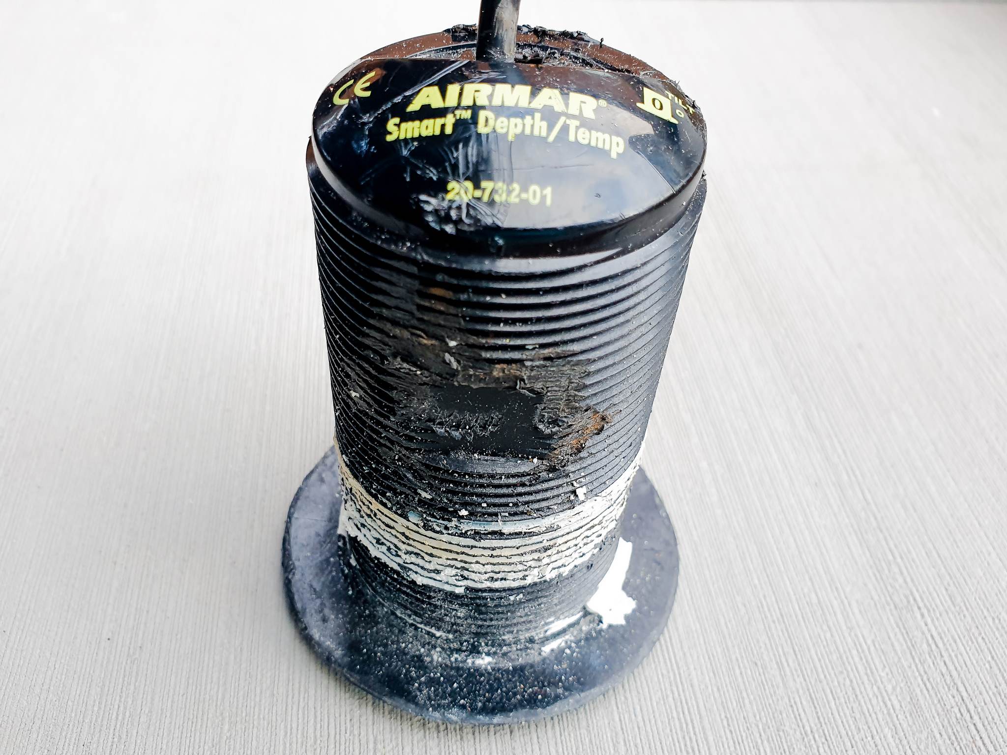

So first remove the existing transponder – FourWinns advise they use 3M 4000 adhesive that does not set hard, run a sharp blade around it and it will come out …… will it hell as like
2 of us spent 6 Hrs cutting around the existing fitting, it had about 5mm spare all round and that was filled with the adhesive, and around 40mm thick hull, and the mushroom dome on the underside was also fitted with 3M 4000.
We snapped a lot of scalpel blades, Stanley blades were not flexible enough.
The unit finally removed looked like this:

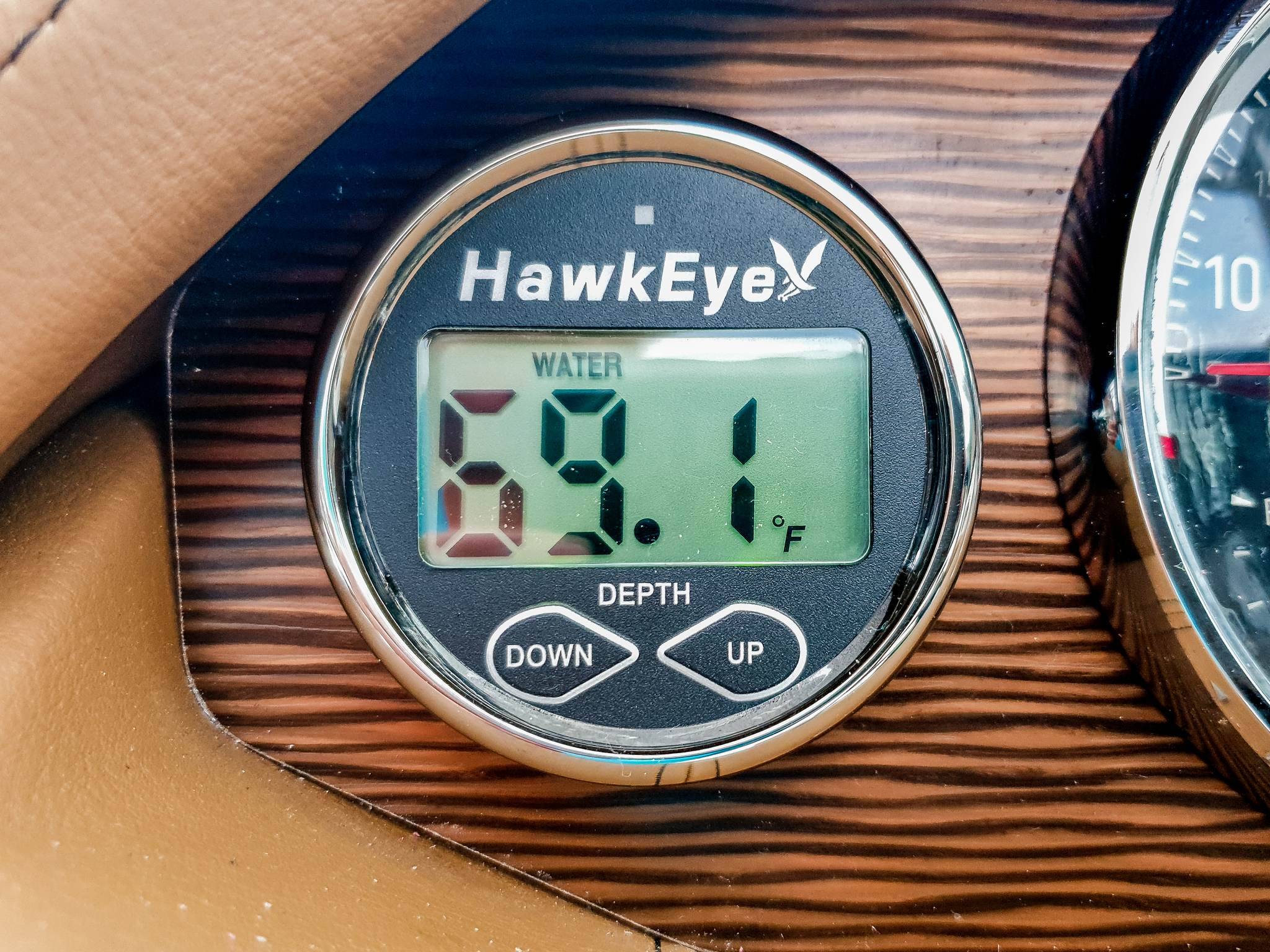

The 2” hole in the dash was already there – just had to remove blanking ‘dummy’ dial, and new display fitted easy enough. Wiring was pretty simple … +12V ‘ignition’ and -12V, the new transducer cable screwed in via watertight connections. There was a short lead with air temp sensor on it …. Just cable tied in a central location behind the dash.
I ordered the chrome bezel ….. they do multiple colours, they simply clip onto the front, they also supply a clip over cover to keep it clean.

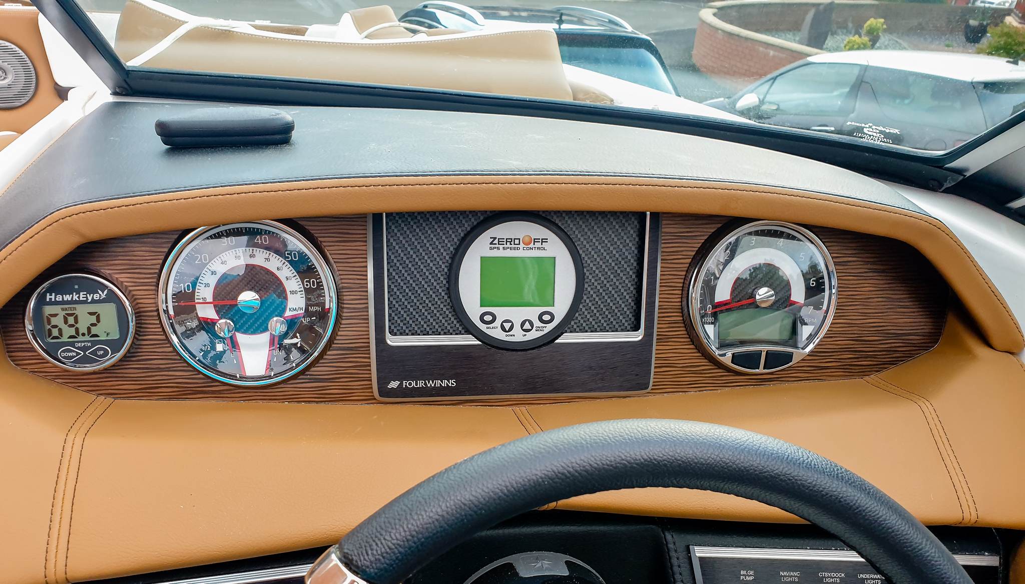

It looks like this is place, pretty neat :

It gives depth in 0.1 foot increments or metric, and air & water temp in C or F, the important bit is the configurable depth alarm …. and a nice addition a Keel offset … here you set the draft of the boat, and it subtracts that from actual depth ……. So if your draft is 3’, you set offset to 3’ ….. then if for example, you are operating in a depth of 5’ the display will show 2’ which is your safe water under the keel
So my dash now has 2 new digital displays …… the GPS Cruise Control and now the depth display.
The black item on the dash is the GPS antennae for the Cruise control
