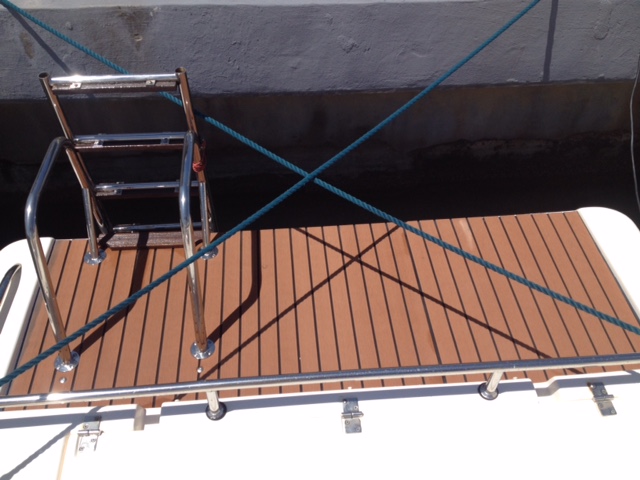

Yes I know we would all like the real thing when it comes to teak decking , but Teak-Tek cheaper alternative, but wow still very expensive ! I wanted to put teak on my swim platform, so decided to start at the other end of the spectrum, Eva foam teak decking on eBay. I ordered a roll in January 2400 x 900, I paid about £60 it arrived no problem. I put It on last week. After removing the swim ladder ( which was quite a palaver) I made a template out of cardboard and cut it to size ( 2 pieces )it is self adhesive with backing paper. It went down a treat and after sealing the edges with mastic, I think it looks brilliant. Its about 6mm thick and comfortable to walk and kneel on and of course non slip ( even the swim platform had a non slip surface, but still very slippery when wet ) time will tell how long it will stay looking good and how long it will stay stuck! I went on eBay the other day to see about ordering another roll for elsewhere on the boat, and now it’s about £35 a roll. A real bargain!
Photo attached
“Teak decking” on Mano Marine 22.52 swim platform

by Ianfs » 06 May 2019, 07:23
You've made a great job of that, looks amazing.
by lewlew100 » 06 May 2019, 11:09
That looks very good. I might try that for the boat that I am building. On some of the 'bay pics they show an edging. Do you know if that is ordered in like that or is it a separate strip cut from the main sheet? Thanks for posting. Geoff.

by wrinklywideboy » 06 May 2019, 20:53
Hi Geoff
We didn’t look to see if there was an edging strip, so I’m afraid we can’t help you on that front. We did consider cutting one ourselves and using a mitre finish on the corners. It would probably be very easy as the foam cuts with just a sharp Stanley knife.
Our thinking was that more edges may present more opportunities for water ingress, so we decided to go for the simplest finish possible.
Sorry can’t be more use than that.
Are you posting progress pics on your boat building endeavour?
Cheers Stuart
