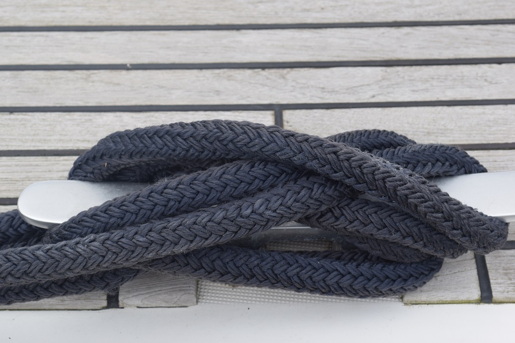

by Ianfs » 21 Sep 2018, 16:23
Sounds like you have ready made mooring lines with spliced loops.
The Hardy's were probably made to take a standard line once round, two figure eights, then a single cleat hitch. If you needed to slip lines in a hurry its the preferred method. Like this....
Cleat hitch.jpg (231.23 KiB) Viewed 19077 times
By passing the line once round it won't lock under pressure then the two figure eights will hold pretty well and can be left but the last hitch is a safety method for heavy weather.
I'm sure there are other methods though. :)
by ChrisH » 21 Sep 2018, 16:30
yep, this is what I do on the dockside, but I do like the spliced loop. :-(
