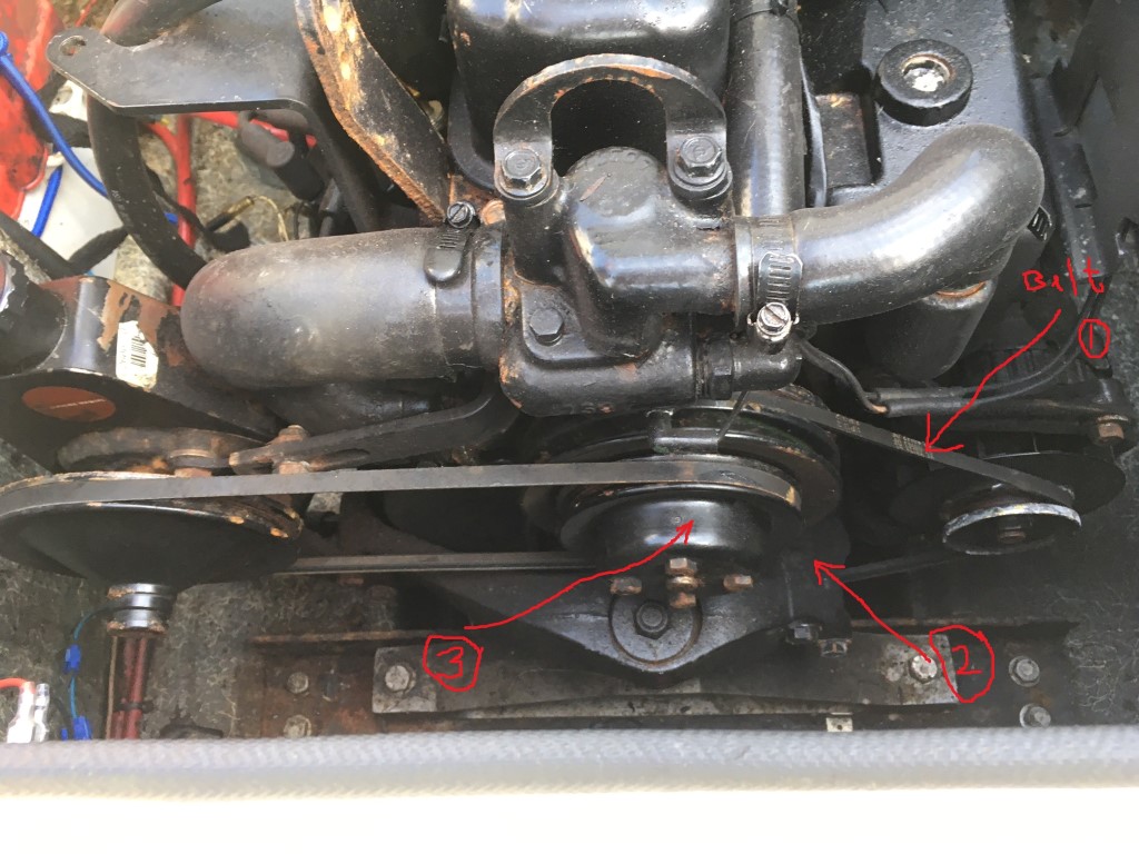

by Bigplumbs » 17 Jul 2018, 16:05
Thanks both Ians. I get the ratchet strap and scaffold thing. I am happy to take of the pully instead of jacking up the engine. I kind of thought that the jack was to hold the engine as I will have to remove a bracket as shown in the attached pic at point 2 marked up. If it is just to save taking off the pully I am happy to just remove the pully

by Ianfs » 18 Jul 2018, 09:48
I thought the same. The marine engineer had already removed the spacer No 2 and the engine was still ok, so I don't really know. He said the starboard side fixings would hold the engine steady, which it seemed to.

by Bigplumbs » 30 Jul 2018, 06:34
The bolts that were metric were the ones holding the alternator on.
Yes we removed the top pulley and in my view it could not have been done without removing that. We found that there was no need at all to support the engine (although we did take the kit) and after removing the lower bracket on the right the engine did not move at all.
The main issue as ever on a boat is the access and the difficulty that this brings together with the pully bolts that took some moving on a thing that rotates. Used a second spanner on opposite bolts and on the last one used the second spanner as a lever on the loose bolts that we undid but left sticking out. Me being too fat also did not help :)
