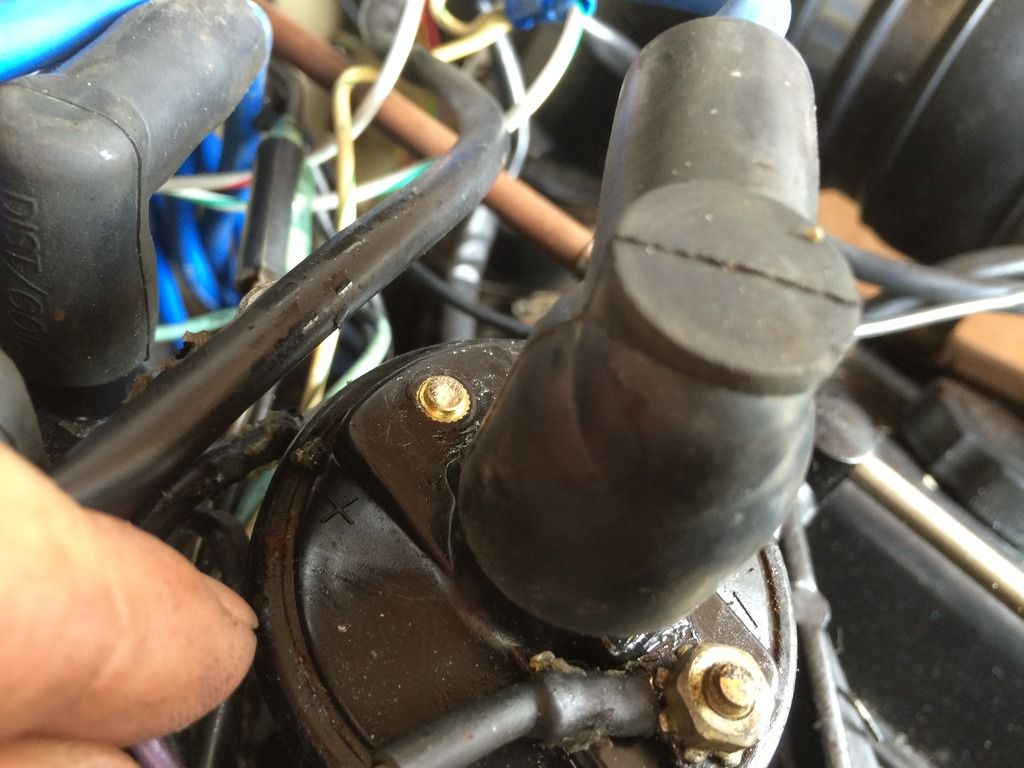

Thought I'd give some of the electrical connections another check and managed to snap one off of the coil..
I suppose now I'll have to replace that and at least I will then be able to discount the coil! ;)
