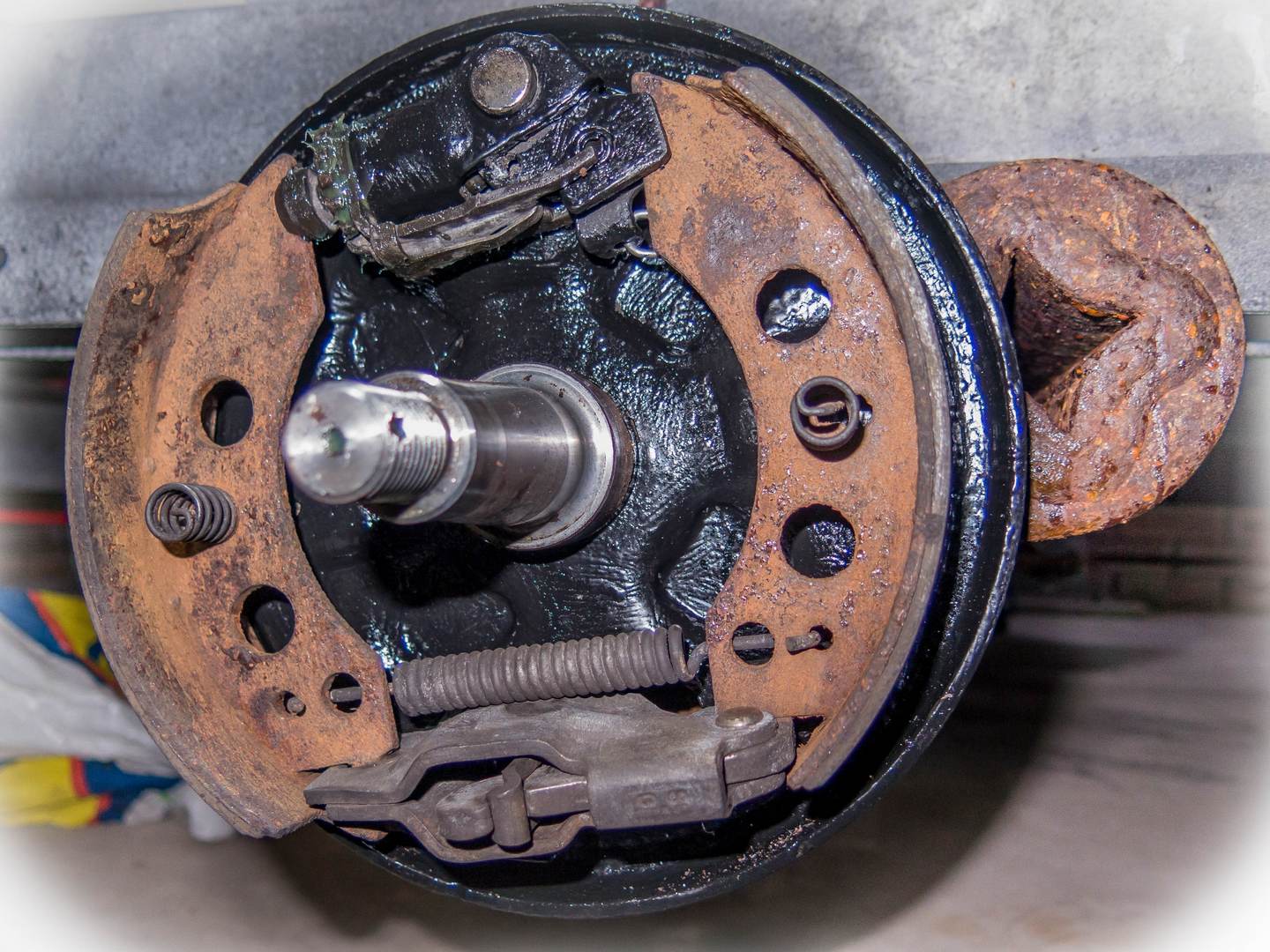

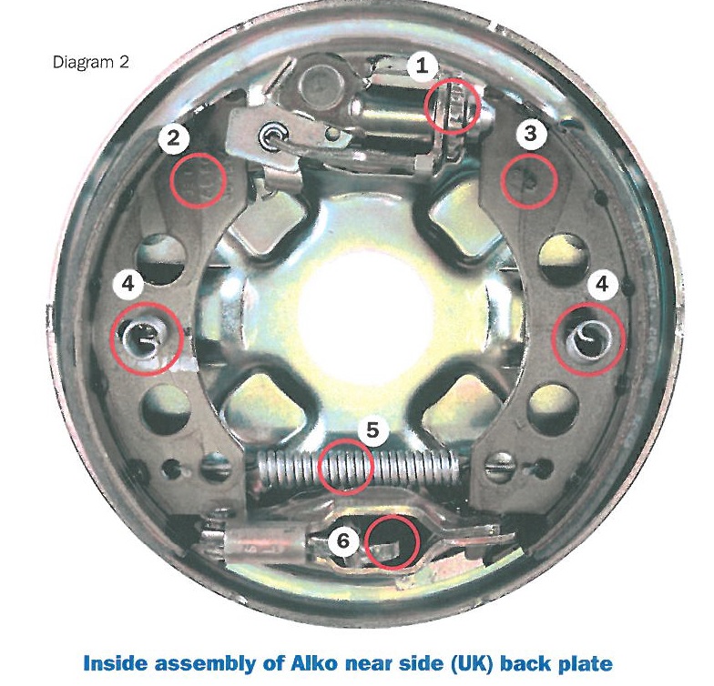

by argonaut » 01 Jun 2018, 12:23
Ianfs wrote:
the instructions say to set rod with no play.
This is the bit I don't get, but I'm no expert. With no play this will mean the brakes will apply very early on during the draw shaft travel, - Indespension manual and Alko documents state actuating rod should be set with zero play for all modern couplings
Indespension when asked said that what should happen is brakes apply as soon as rods move
Assume you mean the steel threaded rod from the front actuator to the brake equaliser? :) - yes, one documents does add up to 3mm play at coupling end
1/ Make sure the brake shoe expanders are the right way round. - actuators installed so hinge pin is on same side as autoreverse cam - book pic & atual pic attached
2/ Adjust the brake shoes so they are just off the drum when towing. - set to locked, then backed off minimum to give 1.5 turns of wheel before drag stops it when spun
3/ Tighten the brake rod to the front clevis. - done
4/ Adjust the rod at the equaliser to apply brakes during the last few cms of travel of the draw shaft whatever adjustment it takes to achieve this, i.e. when the draw shaft comes to a stop when pushed in. - not sure how to do that and avoid play & sag in rod , but have tried it with a lot of play in rod (via compensator cone nut)
Another suggestion, when you are reversing onto your drive are you able to pull forward by about half a metre to release the brakes?yes I can pull fwd with ease, but as soon as I put it back in reverse it locks again
The only other thing I can think of is that for some reason (and I can't actually think of a reason why) but by not having the front wheels on the ground during a reverse manoeuvre in order they release their brakes, possibly forces the rear wheel shoes to stay on. - it is only rear wheel taking load, at start of the reverse, front wheel don't even touch the ground ...
I would love to come and help to see if we could trouble shoot this together but you're miles away, albeit in a beautiful part of the World. :D
Sure I can't tempt you to come down ? ...... sort trailer, out on the water, BBQ .... could meet 1/2 way, or come down and stay overnight :-)
reassembled backplate offside.jpg (231.85 KiB) Viewed 19457 times
Near side brakes.jpg (184.38 KiB) Viewed 19457 times
Posts: 542
