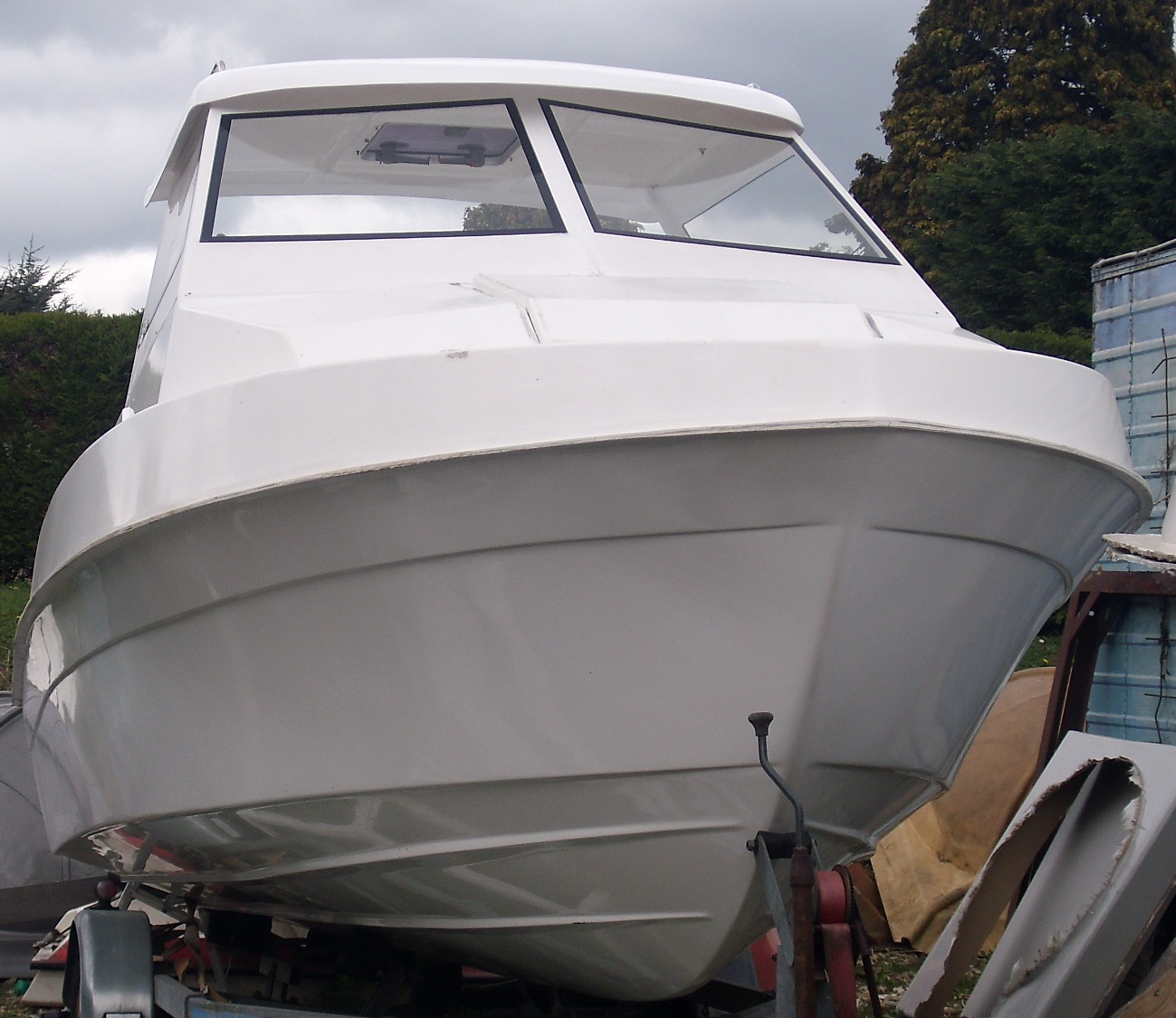

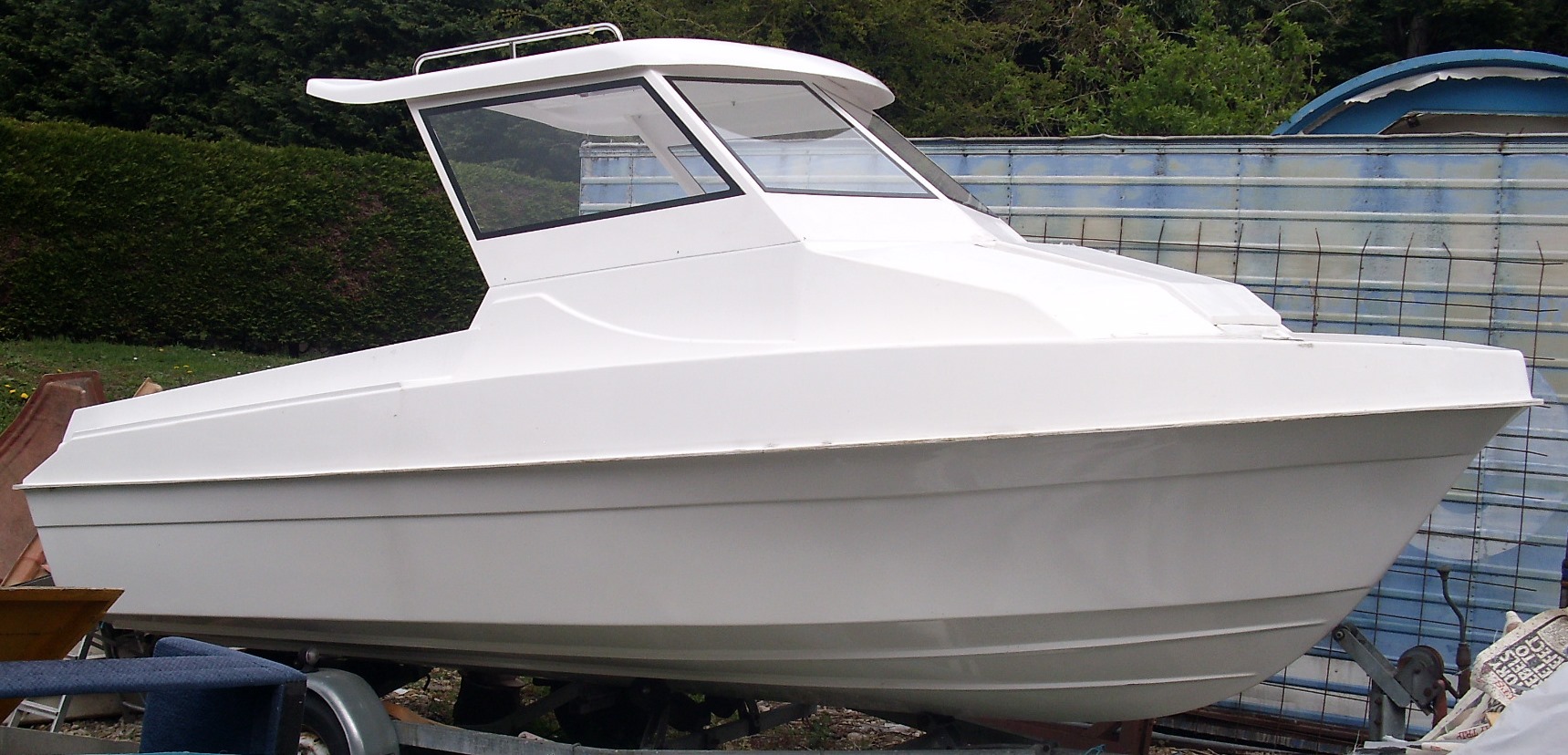

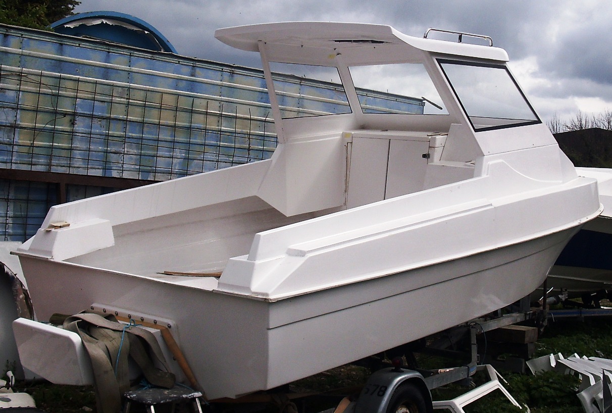

I have just posted a couple of pics on WSF, and am posting them here now. Basically the same as earlier pics, but WH roof and windows now permanently fitted. Geoff.
by betty boop » 10 Apr 2019, 18:33
looks good Geoff, just need to finish the father in laws bathroom refurb and I'll be over to have a look.

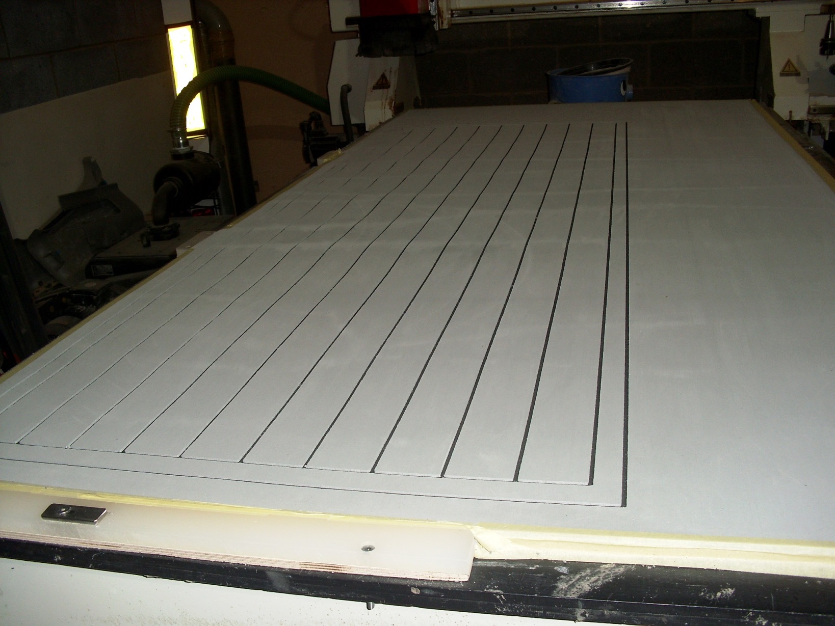

I cut my first faux teak (grey) deck sheet today. I am posting a poor quality pic of it still on the router bed. The crease lines visible across the sheet show up because I switched the vacuum hold down off before taking the photo. Those lines are caused by the paper backing covering the self adhesive sheet buckling when the sheet is rolled up for posting. When the sheet is vacuumed to the bed it is far less noticeable and the routed sheet with planks and margin looks quite professional IMHO. Geoff.

lewlew100 wrote:I cut my first faux teak (grey) deck sheet today. I am posting a poor quality pic of it still on the router bed. The crease lines visible across the sheet show up because I switched the vacuum hold down off before taking the photo. Those lines are caused by the paper backing covering the self adhesive sheet buckling when the sheet is rolled up for posting. When the sheet is vacuumed to the bed it is far less noticeable and the routed sheet with planks and margin looks quite professional IMHO. Geoff.
looks good Geoff are you taking orders yet? I would say I’d swap a new cover for a floor but not sure I want to go through that again
