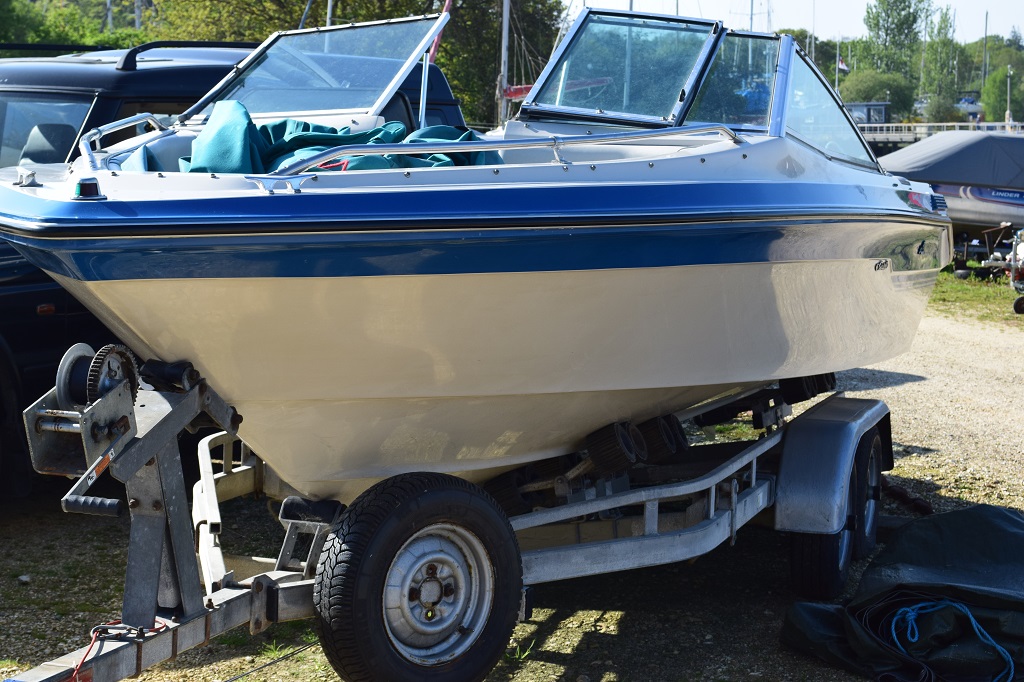

by ChrisH » 06 Jul 2018, 22:06
Zoom in as neededImage
by lewlew100 » 06 Jul 2018, 22:14
That looks exactly right to me - thanks for showing. The winch height is slightly higher than the bow eye, an extended snubber stops any fouling at the towing eye connection and the foremost keel/bow roller is supporting, but not lifting the hull. I presume that the rollers out of site are all doing their bit to support. Geoff.

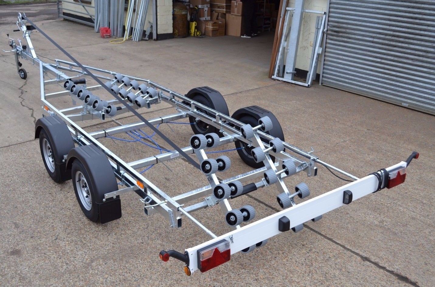

oh dear - get your hat young man...... a worthy suggestion if had it not been just purchased and with no g'teed results - sorry but keep the ideas coming. I'm fixed (not rolling ) on the idea of front supports. my attention is drawn to eBay and the rollers for sale but having seen this picture of Degraff trailers 2600kg model I'm thinking of the idea of moving the forward bunk set - forward. I cant quite see from my pictures at work but the deGraff trailer has its rollers far more forward than the SBS. My thinking being bring it forward (if I can) and the add if req. a set of single or double rollers into the space left over. Degraff sell those 4x roller units for £140.

Degraff copy the Indespension design of the Super Roller Coaster. The thing is because they are swinging arms and yours is fixed, if you put a set of rollers in front, you would have to set them just right. Great idea but not sure if you mean one set of four along the keel. If so surely the V of the hull further forward rolling onto the rollers through the middle would interfere with the bar of the rollers?

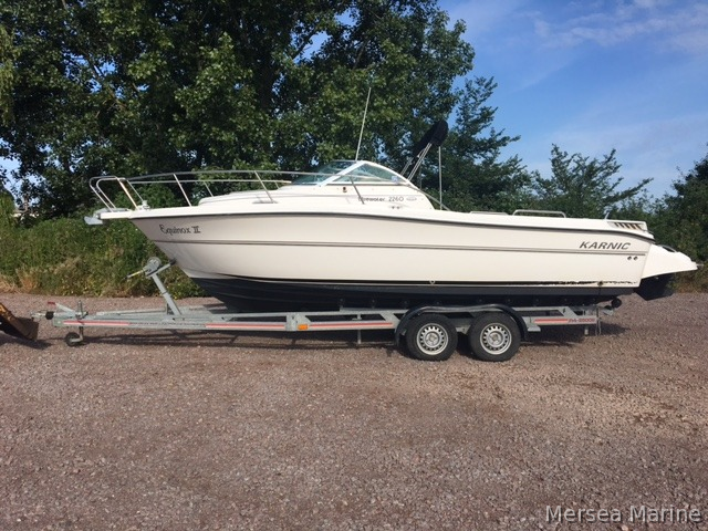

not quite - I mean adding a set of 4 rollers (per stem) on either side forward of midships so they line up either side of the chine rails, think I've said that right. Had a look at Google again searching twin axle roller trailers looking for Karnic or boston whalers shapes on rollers. What I seem to find in 70% of cases is the rollers are forward of the front axle more so than mine. If you recall my moaning of SBS quality a while ago it seems some of that should of been aimed at the set up of the trailer/dealer/package not necessarily SBS themselves and I'm wondering IF this shape of boat/hull should have been set up differently, with so many mistakes being made may be this is just another? Some examples on google have 3 sets of 8 rollers, some 2 sets front and back, some bunks go the full length of the hull- my rollers only support the rear 2/3 of the hull, leaving the front to be unsupported or very little support from crushed rubber/bent spindle V keel rollers.
Geoff will read with a smile that moving the front bent snub roller back is on the cards also but my biggest concern is support and damage I risk causing to myself or the boat by the lack of it upfront. decision time dawns :lol:

From your photos in the first post (now call me stupid) it looks as if there is only one set/group of rollers at the rear. In the photo above there appear to be two sets of rollers both fix supporting 2 thirds of the hull (basically most of the weight).
So from experience, with this amount of rollers, she should slide on and off nicely. Here's what I think.
The other day a local chap at Bucklers launched his Rib, it was at least 19ft and was on a nearly new roller trailer and the Rib only looked a couple of years old. He got to almost submersion, with the Rib and rollers out of the water, he unclipped the bow eye and expected it to just roll off nicely. He spent the next 10mins bouncing it off and with my help and another guy we managed to bounce it off. his rollers were well stuck. Now a couple of years ago mine were the same and it became harder and harder to recover the boat. I refirb'd all my rollers, including new Stainless Steel washers, split pins, bolts, lock nuts and roller sleeves etc. so they all roll easily and the roller arms pivot as the should.
Although we have launched and recovered many times since then and I have to say with absolute ease, when the boat went in the other day at a very shallow angle because the tide was high (long story at Bucklers), as soon as I released the winch strap she rolled back onto the safety line without resistance. Once started even at a shallow angle she rolled back without issue. On return she was no issue to recover.
So with the resisntance of the lower front bow roller and maybe the main sets of rollers, could this be a contributing facture to your problems?
